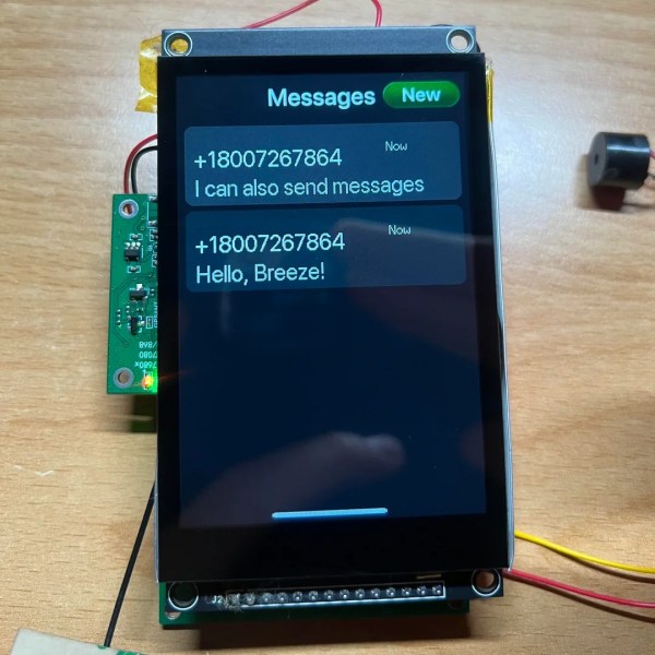

You may or may not be reading this on a smartphone, but odds are that even if you aren’t, you own one. Well, possess one, anyway — it’s debatable if the locked-down, one-way relationships we have with our addiction slabs counts as ownership. [LuckyBor], aka [Breezy], on the other hand — fully owns his 4G smartphone, because he made it himself.
OK, sure, it’s only rocking a 4G modem, not 5G. But with an ESP32-S3 for a brain, that’s probably going to provide plenty of bandwidth. It does what you expect from a phone: thanks to its A7682E simcom modem, it can call and text. The OV2640 Arducam module allows it to take pictures, and yes, it surfs the web. It even has features certain flagship phones lack, like a 3.5 mm audio jack, and with its 3.5″ touchscreen, the ability to fit in your pocket. Well, once it gets a case, anyway.
It talks, it texts, it… does not julienne fry, but that’s arguably a good thing.
This is just an alpha version, a brick of layered modules. [LuckyBor] plans on fitting everything into a slimmer form factor with a four-layer PCB that will also include an SD-card adapter, and will open-source the design at that time, both hardware and software. Since [LuckyBor] has also promised the world documentation, we don’t mind waiting a few months.
It’s always good to see another open-source option, and this one has us especially chuffed. Sure, we’ve written about Postmarket OS and other Linux options like Nix, and someone even put the rust-based Redox OS on a phone, but those are still on the same potentially-backdoored commercial hardware. That’s why this project is so great, even if its performance is decidedly weak compared to flagship phones that have as more horsepower as some of our laptops.
We very much hope [LuckyBor] carries through with the aforementioned promise to open source the design.

      1. The current apps are just C++ functions that are numbered like runApp1-12 for example, but the final version will have truly portable python apps (since loading elf’s is a pain), so for now its hard coded, but there will be portable apps loaded from an sd card to actually be a full smartphone by definition, right now its a smartphone-like dumbphone which is cool too, but it will be an actual smartphone since custom apps arent a huge priority right now (I need to finish all the preloaded apps first)

    4. I already have plans for adding in user installed apps, via micropython for it to have the definition of a smartphone, why micropython? Yes its slow but it’s easy for people to write with, and easy for me to implement, a win win situation here. But yeah for now it only supports static compilable apps, and if you want your custom apps in C++, once its going to be open source, you can just write them and flash them natively.

    1. The battery will be replaceable just by unscrewing the contacts, and the esp32 s3 just streams CD quality audio, nothing super HD since its not needed, and an SD card will be in the final version, and the final 4 layer PCB which is currently in the schematic stage is being worked on to be ultra thin, hopefully it’ll work!
