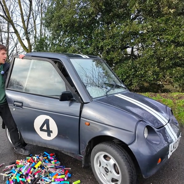

Disposable vapes aren’t quite the problem/resource stream they once were, with many jurisdictions moving to ban the absurdly wasteful little devices, but there are still a lot of slightly-smelly lithium batteries in the wild. You might be forgiven for thinking that most of them seem to be in [Chris Doel]’s UK workshop, given that he’s now cruising around what has to be the world’s only vape-powered car.
Technically, anyway; some motorheads might object to calling donor vehicle [Chris] starts with a car, but the venerable G-Wiz has four wheels, four seats, lights and a windscreen, so what more do you want? Horsepower in excess of 17 ponies (12.6 kW)? Top speeds in excess of 50 Mph (80 km/h)? Something other than the dead weight of 20-year-old lead-acid batteries? Well, [Chris] at least fixes that last part.
The conversion is amazingly simple: he just straps his 500 disposable vape battery pack into the back seat– the same one that was powering his shop–into the GWiz, and it’s off to the races. Not quickly, mind you, but with 500 lightly-used lithium cells in the back seat, how fast would you want to go? Hopefully the power bank goes back on the wall after the test drive, or he finds a better mounting solution. To [Chris]’s credit, he did renovate his pack with extra support and insulation, and put all the cells in an insulated aluminum box. Still, the low speed has to count as a safety feature at this point.
