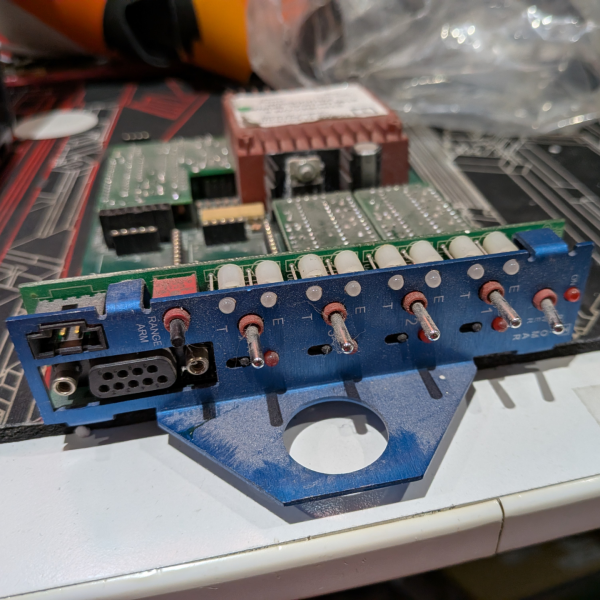

A circuit board card is shown, with a blue panel on one side. On the panel are switches and an RS-232 port.

To reverse-engineer the Strobecom protocol, [xssfox] managed to buy a Strobecom optical signal processor, which would normally detect an emergency signal. This worked by modulating the length of infrared pulses. After some brute-forcing, a transmitter using an Arduino Nano and an infrared LED managed to activate the preemption signal, and even to transmit a vehicle ID. It seems that Strobecom systems, at least, are fairly demanding in terms of the signals they accept; signals had to be precisely timed, and in at least some systems, a valid vehicle ID would be needed to change the light.

  1. Sure are a lot of big, fat, easily-bumped switches for something going into a government vehicle. In the past, they seem to have preferred internally-configured bricks for things like this… even for radios. They sought to make them “idiot-proof”. I have several of the old Motorola bricks that have been reconfigured for 6m.
    1. Shown is the receiver that is part of Traffic Light control. Not the transmitter that goes into the vehicle. I would assume that one is indeed just a black box.
  2. This is the receiver, which would be mounted inside the traffic light control box. The transmitter would be smaller and likely configured with internal dip switches.
