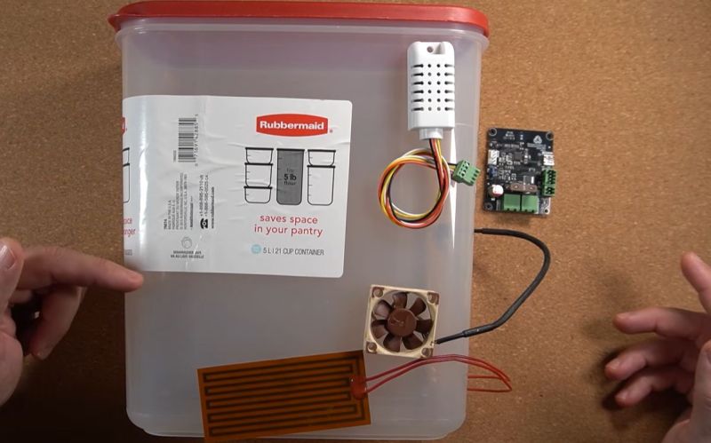

In a recent video [Saša Karanović] revisits the DIY filament dryer that he gave a shot a couple of years ago. Back then he reused an existing filament dryer, adding a custom controller and such to improve its performance.
This technically-not-fully-DIY dryer got some feedback since then, and thus the V2 version is an example of how to better DIY such a dryer, including a custom PCB and a GitHub project for all the details.
Those who just want to dive into the documentation for assembly and the BOM can look at the available documentation. At its core the whole assembly consists of some kind of container like the shown 5L food storage type, along with an SHT30 temperature and humidity sensor and 100 K NTC temperature sensor. These connect to the controller board which then switches on or off the 12 V polyimide resistive heater.
One thing that could be improved here is that the saturated warm air has nowhere to go. This is a common issue with filament dryers and why it’s recommended with even commercial filament dryers like the common Sunlu types to leave them slightly ajar so that the moist air can be replaced with cooler air that can much more readily absorb moisture.

  1. I never understood, why the filament dryers are designed without air exchange. There should be a fan moving air out of the container. Ideally this would be connected to a small (3d printed) counterflow heat exchanger, so the hot air going out gives the heat to the cold air coming in. The fan only needs to run every 30 mins or so.
    Couple that with a simple double walled isolation and I bet that would even use less energy then what we currently have.

    2. I bought a used wine fridge slapped a shop light in it plugged into a thermostat. I can maintain 100degF at 10% humidity all day. I also put a little USB fan in it. I can store 25 rolls in there indefinitely. I have vent in the side near the top that allows air/humidity to come out and a tray of dessicant at the bottom. The whole thing cost about 75 bu ks to make. You guys over think it.

  8. I built something similar using an 11qt Ikea 365 container with upside down, and 3D printed a Little smoke stack kind of thing for a blower fan with a cap on top of the stack, so every 30 minutes or so it blows the air out for a few seconds.
