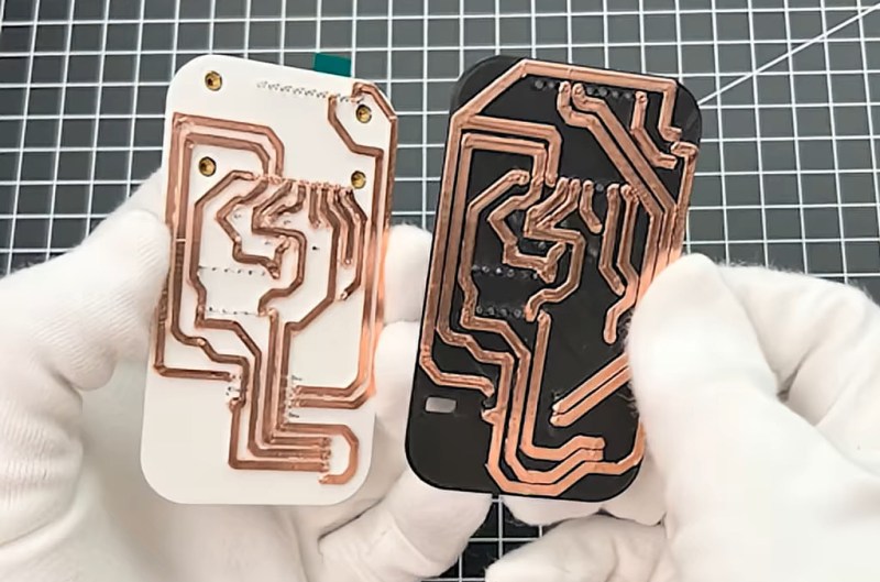

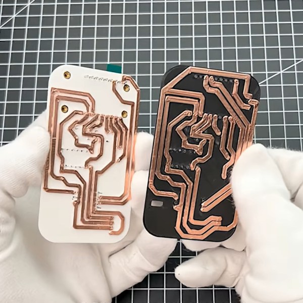

Using 3D Printers To Make Circuit Boards
Two printed circuit boards made from 3D prints and copper foil. One white and one black substrate.
Custom printed circuit boards have become more and more accessible to the average hobbyist over the last decade. But one problem still remains: your circuits will take at least a couple days to make. But what if you needed some really rapid prototypes? [The Raccoon Lab] shows us how to do it with a 3D printer.
You start with the usual hobby PCB pipeline: take your idea, make a schematic, and then lay it out in KiCad. That’s where the changes start: to keep traces strong, they are made very thick. The PCB is then exported and opened in 3D CAD software, where the traces are extruded to be 2 mm tall. Off to the printer! The newly printed “circuit board” is made conductive by applying copper tape to it, and traces are cut out along their raised edges.
The result is a very quick and dirty PCB. Sure, it isn’t exactly production-ready, but for just about any simple microcontroller project it’ll do just fine, and it’s a whole lot more accessible than milling one using a CNC! We’ve seen a few variations on this approach recently, including some custom software designed to help along the process.

  6. My thought to the questions posed was, CNC milling. That idea was shot down right at the end with the justification that this is “more accessible,” but its also more limited and possibly a bit slower and labor intensive than just milling. A 3D printer is already a CNC, so really it’s a software problem to say that 3D printing is more accessible. Especially if you can reach higher density with a mill, a single sided board even with a few jumpers would be easier to make than this type of 3D printed board.

  10. If one wanted to do a 3D printer (because maybe you don’t have a CNC or Circuit), I bet the following combination of known techniques would work well:
    Print with the traces RECESSED about half a millimeter or more. Holes can be included, and you could even do double sided if the bottom layer traces are angled grooves.
    Brush (temporary) conductive paint mostly into the grooves
    Sand for a few seconds to remove excess paint that is outside of the grooves / traces
    Electroplate with a glass of vinegar and household battery. Electroplating with copper is easy — I did it when I was a small child. I ended up with a copper-plated quarter and a nickel-plated penny when they swapped metals.
    That will even plate your through holes.
