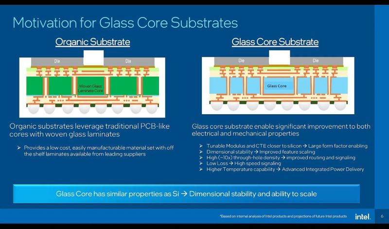

Glass-based substrates are slowly beginning to push out organic substrates – as also commonly used in PCBs – due to often superior material properties for packaging. One area where glass substrates have however struggled is with through-hole vias and providing the conductive copper path through them. A 2024 article by [Keith Best] gives a good overview of the topic, with recent news showing how much companies like Intel are pushing for glass substrates, specifically for the packaging of dies.

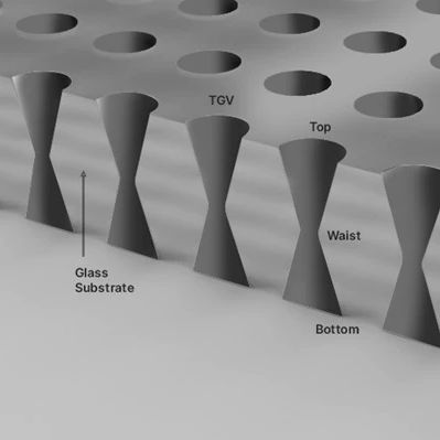

One major advantage with vias in glass substrates is that they can be much smaller, enabling smaller than 0.1 mm diameter holes with far finer pitch. The challenge here is to make perfect holes with a laser that are defect-free, as well as have the intended diameter.
After that this through-glass via (TGV) has to be coated or filled with copper, much like their organic equivalent. Said TGV can be fully filled with copper, or use plating and add dielectric filler. Detecting flaws in such a finished TGV is important.

The complications of creating TGVs with femtosecond laser pulses in Borofloat 33 glass are highlighted by [Daniel Franz] et al. in a 2025 research article, with microcracks and backside ablation observed without proper precautions, something which previously was often resolved by an etching step following said laser drilling. The main issue here is the post-drilling residual stress from the thermal shock, which the authors demonstrate can be largely prevented with careful tweaking of the laser drilling parameters.

    1. I’m fairly confident the main use for this would be large BGA packages or, even more importantly, their package-less cousins the flip-chip ICs. Instead of using bond wires and attaching those to pars in an IC package, you flip the chip over and press the silicon directly onto the PCB. (Get it?) This saves money mostly because making bond wires is hard and also because packaging is mildly difficult (extra material, gotta make the pins or balls, gotta keep them dry so they don’t pop). The biggest use case for a substrate (PCB material) with a coefficient of thermal expansion that matches silicon ICs is putting many of these flip-chip ICs on a board and allowing them to talk to one another. Don’t let anyone fool you, those glass-substrate boards will then be connected to a normal fiberglass PCB. This glass substrate is intended for very high speed digital/analog/RF applications including ASICs and modern CPU designs. The closer together you can put these devices, the faster they can run. The less the difference in coefficient of thermal expansion, the hotter they can run. Putting all your fancy chips for a laptop (for example) on a glass substrate that runs at 120C (pulled out of nowhere) would allow better performance without burning the motherboard as much as it currently does. Feel free to correct or comment.

      When looking at the first picture, there is a “die” in top, and on the bottom something that looks like BGA bumps. That would put it in the application area of an interposer. https://en.wikipedia.org/wiki/Interposer
