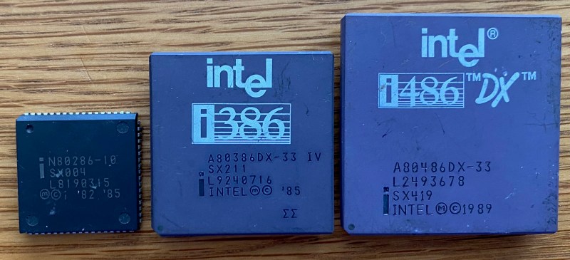

Top image: line-up of Intel 286, 386 and 486 CPUs. (Credit: Sgroey, Wikimedia)
