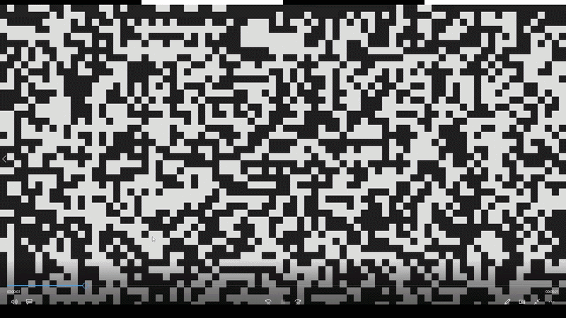

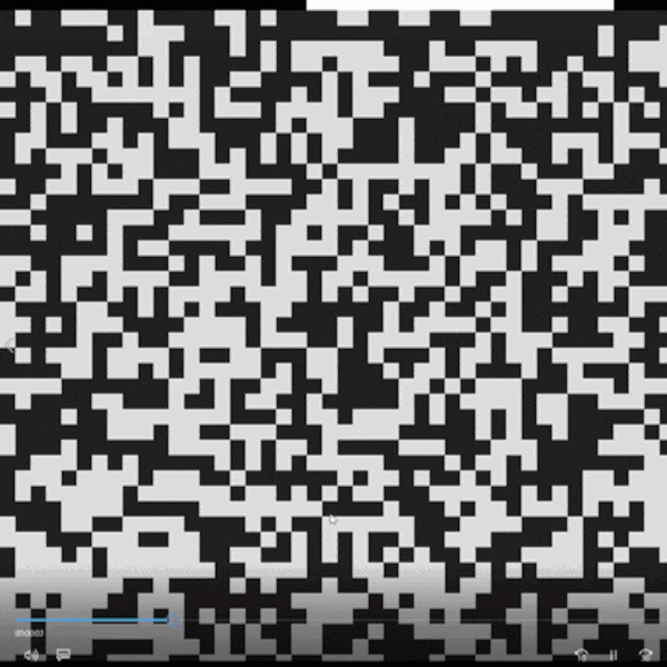

Storage is expensive these days, whether you’re looking at the prices of spinning rust or magic little sticks of silicon. But what if there was some benevolent overlord that you could trick into giving you unlimited storage? That’s where Noisecloud comes in.
Created by [Lucas], Noisecloud is a tool that lets you use YouTube as a form of effectively-unlimited file storage. It works by taking whatever file data you have on hand, and turns it into frames of digital noise that can be stored and transported as an MP4 file and uploaded to YouTube. The encoding process involves first compressing the data with gzip, then packaging it into a high-constrast series of video frames that are then encoded with FFmpeg. Video containers can be produced in various resolutions, all the way down to 640×360 @ 30 fps. There’s also a special “TikTok mode” which is optimised to best preserve data on short form sites that use vertical orientation as default. More commentary from the creator is available via the supporting article on Github.
It’s probably not a practical way to store your files, given the fussy encoding and decoding required to actually use the data. However, it’s an interesting proof of concept that explores how data can be stashed in unexpected places via publicly-accessible services. We’ve explored similar work before, too.

There’s not much stopping you using full colour and 30fps, if you compensate for encoding.
That’s potentially a lot of data compression, at the expense of some decoding speed.
yt-dlp, then split the video in to one image per frame.
Probably…what happens to your backup restore operation though if your video gets reencoded by YouTube or on-the-fly by a carrier because of your data plan or roaming location?

Lucas, creator of NoiseCloud here…
I saw some comments talking about AI review after the video upload (just to clarify, the verification happens once when you upload the file and then only through reports, since the video is private, it won’t happen). I submitted a report to Google about this issue, since it makes it easier to use YouTube as a C2 server. As of now, Google hasn’t fixed the issue, saying that the malware would not be executed within the platform, but only after being downloaded, which is insane, LOL.
Another point: when you upload a video, it goes through internal compression on YouTube. Initially, I used the Reed-Solomon algorithm for recovery, now I’m using a proprietary algorithm from a private project. NO OTHER SIMILAR PROJECT, PUBLICLY, HAS MANAGED TO REACH THIS LEVEL.
1 – 100% encode of any file
2 – Reduced overhead, the lowest publicly, using Weaver version 1.0
3 – Processing time for decoding
4 – 100% decode
PS: About what I mentioned earlier regarding AI, it’s not speculation, it’s Google’s response after the report, especially since this project started from a bug bounty (CVE-2026-3084).
