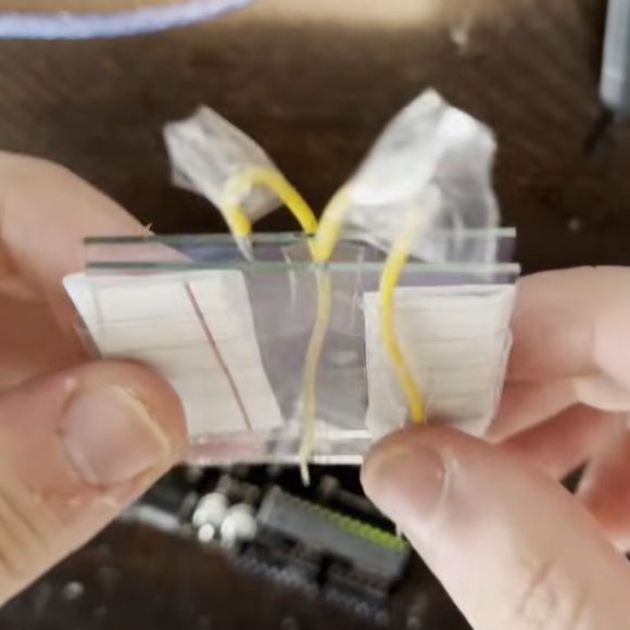

Although generally glass isn’t associated with touch-sensitive surfaces, the addition of an ITO (indium tin oxygen) coating adds the exciting property of not only being transparent to the visible light part of the electromagnetic spectrum, but also of being electrically conductive. The logical result is that fine folk like [Sokol] simply had to use their newly acquired ITO-coated glass to make a button out of.
Here the easy option is of course to just use it as a capacitive sensor where the conductive ITO layer is used for the capacitive charge and the glass provides the insulator, but here we see it demonstrated how to create a pressure-sensitive implementation instead.
The measured conductivity on the ITO-coated glass in the video is pretty good, at just over 20 Ohm. This thus makes said capacitive button very easy to achieve. To make it a touch-sensitive button, two pieces of glass are used, with the ITO sides facing. Paper is used to create a spacer, after which the slight flex of the glass allows for the two ITO surfaces to touch, completing the circuit.
This is somewhat similar to how resistive touch screens work, with the position of the finger or stylus determined by the resistance between the two sides. In a hobbyist setup this would make it fairly easy to create a multi-position touch screen using just two pieces of glass and some firmware.
