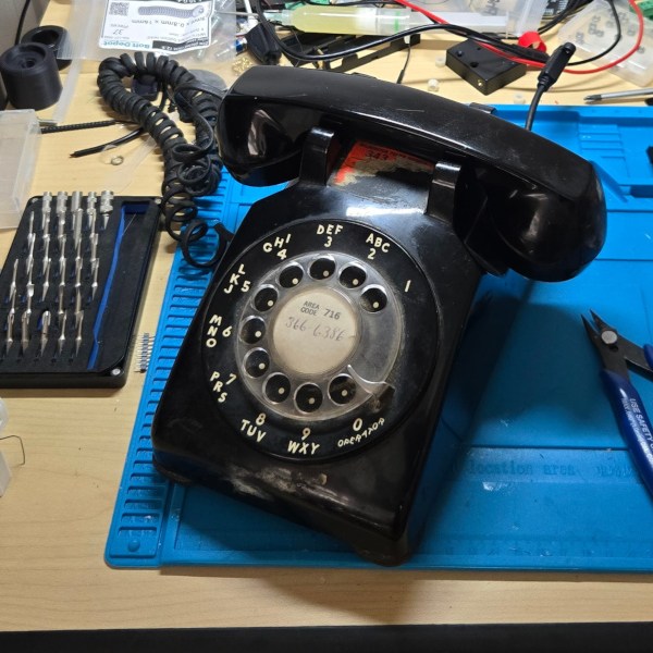

It’s said that a teenager given a rotary telephone in 2026 would be mystified by its operation, yet there are enough surviving instruments for them to be an attractive target for a project. But just what project? [fregacmols] is here with one possibility, turn that old phone into a cellphone.
Connecting to the phone is a subscriber-line interface module, containing all the electronics to simulate a copper phone line. This in turn feeds audio and control wiring to a Lilygo ESP32-S3 board which provides the brains as well as talking to a cellular modem. We especially like that this allows the phone to be used entirely unmodified.
The software does a good job of simulating a North American subscriber line, complete with dial tones, and ringing the phone’s bell on an incoming call. There are a couple of special codes, one to open a wireless network for maintenance, and the other for diagnostic purposes.

I’m actually planning to add a phone number whitelist feature to the firmware so it can be used exactly like this! As it is, 900 numbers and 911 are not fed to the modem by the ESP32 (I’m the one who made it, if that isn’t obvious), so adding a user-configurable whitelist should be pretty straightforward.
An ESP32-only WiFi version would certainly be possible too, but then you’re basically building a little VoIP system yourself.
