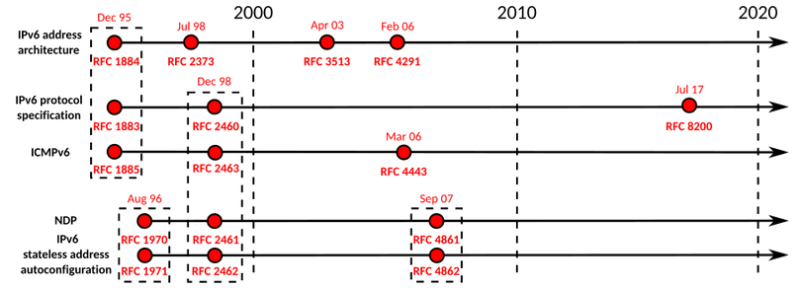

A 2017 Standard
The slightly smaller elephant in the room that’s hiding in the shadow of the neon-sign-adorned IPv6 elephant is the one wearing a hand-scribbled RFC 8200 sign slung around its neck with a bit of bailing rope. This was namely when the IPv6 RFCs received the ‘Internet Standard’ level of maturity, leading some to question whether the push to switch to IPv6 during the years prior was at all warranted.
The timeline of IPv6 RFCs up till its Internet Standard level. (Credit: Michel Bakni, Wikimedia)
This little factoid is just one of the many problems that networking people have with IPv6. For example this 2020 rant by Teknikal_Domain, with the main focus being that instead of being just an IPv4 with 64-bit addressing space and some of the warts of IPv4 smoothed over, it saw fit to add many details and complexity that nobody asked for and fresh warts that could have been easily prevented.

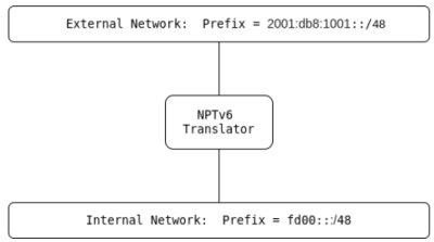

A UDP Discovery Perspective
 NPTv6 Translator interconnects two network links, one of which is an "internal" network, and one of which is an "external" network. (Credit: EidenNor, Wikimedia)
NPTv6 Translator interconnects two network links, one of which is an “internal” network, and one of which is an “external” network. (Credit: EidenNor, Wikimedia)
While the idea of cleaning up IPv4’s messy broadcast address options with a simple multicast option is a good one that I’ll definitely be giving a shot in IPv4’s multicast feature, and the lack of subnets a welcome simplification, the whole concept of service discovery gets a bit weird with IPv6.
The first is that IPv6 doesn’t do NAT and unless you use the non-routable prefix your LAN will not be private in the IPv4 NAT-ed LAN sense. Fortunately IPv6 does do NPT, which is essentially NAT, but with prefixes instead of addresses, so it’s totally different.
Although with routable IPv6 prefixes you could totally do a global address space service discovery, this would obviously be less than desirable. Since service discovery tends to be just about devices on the LAN anyway, this makes the use of IPv6 at the very least a questionable proposition, and a liability in the worst case.
