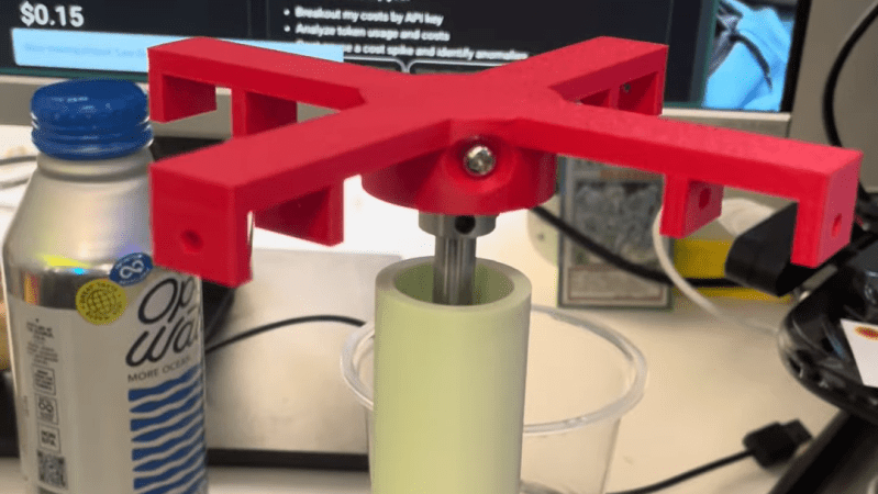

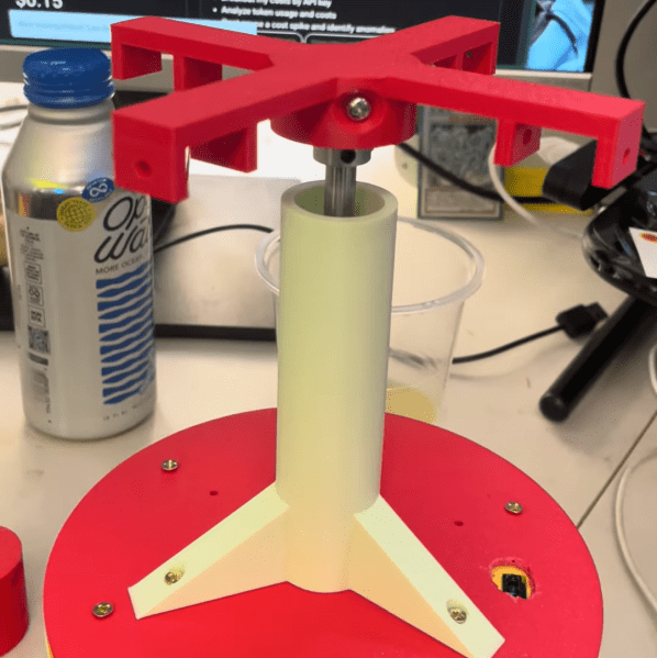

His goal was to separate T cells from blood for further lab analysis, and he needed to be able to work with blood in 15 mL conical tubes. Capable centrifuges weren’t affordable, but he figured he could build his own quite easily. To that end, he enlisted a Raspberry Pi Pico, a 3D printer, and an A2212 brushless motor with a 30 amp electronic speed controller.
Soon enough, he had a design for a fixed-angle centrifuge design that could spin up blood products to the required speed for separation. It has useful safety features, like an MPU-6050 for vibration detection to shut down in case of dangerous imbalance, and an IR sensor for monitoring and controlling rotational speed. For now, the project is still in development, with the first version built and spinning. [Thomas] aims to check that the build operates safely and can separate fluids like dyed water and glycerol successfully before running it with real blood products.

      1. No, he can’t do this stupidity. The blood separation process requires specific conditions in order to be repeatable scientific process. Which means the blood vial centrifuge needs to spin for specified amount of time and with controlled either RPM or RCF (g-force). Also, it’s basically mandatory to have carousel balance protection, both during start-up and during actual spin.

  4. I applaud the attempt, but I can’t determine how they want to mount the vials. From what I’ve seen, usually the vials are loaded from the inside out, which also makes the setup a lot more compact. One disk with vial sized holes at a slight angle, with a hub motor. Something like the OpenSCAD mockup below

  6. A very important detail which is not seen in the video is how the vials are mounted on the carousel. There 2 basic types of mounting – fixed angle and swinging/adaptive. Both work.
    Btw, there are standard sizes (diameter) for the vials, but these include several different lengths of the vials. The carousel is typically sold with rubber/foam adapters which are put at the bottom of the socket to support the vial during rotation and to prevent any mechanical load from tearing-off the plastic cap and ruining the sample.
  7. And one last comment (I promise) – there should be a protective enclosure (even an ugly one) around the rotating carousel, that must be able to fully contain all possible damage at emergency – what could possibly go wrong when spinning someone else’s body fluids @ 3-5k RPMs for 15min?

  8. No biological substance should ever be centrifuged in anything other than a certified biological centrifuge to 1. Prevent aerosolization the material,. 2. Prevent serious injury from flying debris during a destructive failure 3. Prevent accidental contact with the spinning mechanism. That’s a dangerous device.
