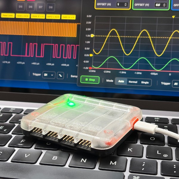

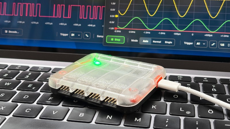

When working on an electronic project it’s likely you will find yourself working with a variety of different instruments, be they logic analysers, oscilloscopes, or whatever. These can take up a lot of space, not to mention cost a bundle of cash. [Max.K] came up with PicoLab as a solution, it’s an all-in-one box containing a four-channel oscilloscope, eight-channel logic analyser, GPIOs, a data logger, and serial, SPI, and i2C interfaces. There’s even an adjustable power supply!
Behind it all is an RP2350, in its larger package with more pins, coupled to some custom interface and protection circuitry. Perhaps the cleverest part is its interface, which it serves as a web site on the network card it exposes through the USB port. Any OS that supports a web browser and USB networking can thus use this thing. You can find all the code in a GitHub repository, should you wish to have a go at building one yourself. We like this idea.

I can’t say these devices are that rare anymore, but i can appreciate the simplicity of the hardware. It is an army of bi-directional transceivers along with a I2C voltage regulator, some current measuring amps and the RP2350B hardware. It is simple, yet effective and i am definitely checking out that MP28167-A I2C Regulator.
Firmware is a bit of a mess though as everything is crammed into a single C file of ~2900 lines. It definitely could benefit from getting split up by functionality so that it is easier to maintain or for others to re-use. I guess messy code is just going to be a recurring theme in this AI-powered era.

The project page mentions multiple ADCs, which is basically not true. The rp2350 has only a single ADC with several multiplexed inputs and can perform a single ADC conversion at a time. Sampling several inputs means that ADC conversions are not happening at the same time, so displaying the channels’ waveforms aligned as if they were sampled at the same time is basically misleading.
Maybe the waveform viewer can be updated to properly display that each consecutive channel is offset by 1 ADC conversion period, which would be a little bit strange when looking at, but would be at least technically correct.
I completely agree that this behavior is not project author’s fault and only due to technical limitations of the rp2350, but still wanted to outline it for the sake of completeness.
Putting several rp2350’s on the same board and synchronizing their ADC acquisition will definitely solve this issue of parallel sampling, but it’s more complex in terms of design and implementation efforts. I’m just sharing thoughts on the fly.
Kind regards.
Hi Nik, thanks a lot for the feedback! You are right, I should have written ADC channels instead of just ADCs. With the test that I have done so far I never noticed the offset between channels, but it’s technically there. It should not be too difficult to just shift the channels in the scope waveform.
Hi Max. It’s interesting that you haven’t seed an issue there, as it should be observable. Let me give some examples.
Let’s choose 500 ksps Fs for a single channel. For sequential sampling of 2 inputs that’s 250 ksps effective Fs. Let’s tie the 2 ADC inputs in parallel and feed them with a sine-wave with frequency between 1/20 and 1/10 of Fs (12.5 – 25 khz). You should be able to observe a phase shift in the recorded waveform if the scope inputs are sequentially sampled, and on parallel-sampled inputs the sine-waves should be always aligned (+/- the adc s/h circuitry and trigger uncertainty).
Another test is to have 2 square-waves with phase delay of ~0.5-1 ADC sample time (1-2us) to each other. On the sequentially sampled scope they’ll look either aligned or with doubled delay, depending on the scanning direction.

When I have multiple instruments on my bench, one of my biggest annoyances is all the wires lying around. I couldn’t find any pictures of the PicoLab actually connected to a device-under-test, so I don’t know what kind of cables I would need with one.
Or did I just miss it?
