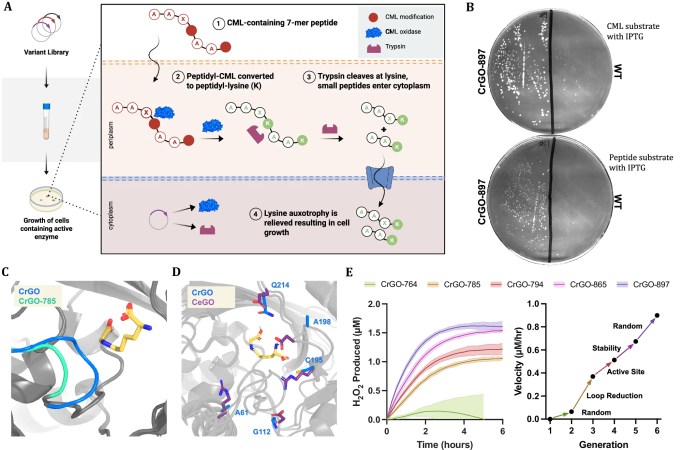

The challenge here was to design this enzyme, which used a genetic selection approach in modified E. coli to narrow down suitable enzymes, optimized for dealing with free CML. Once they were fairly confident that they had a working enzyme, they had to test it and observe the results.
This testing was performed in model proteins in vitro, as well as in tissue samples from elderly donors. These latter included lens, skin and arterial tissue, all of which are long-lived tissues that have plenty of time to collect CML. After treatment with CMLase the presence of CML in these tissues was reduced by 55% for skin and 75% for arterial tissue.
