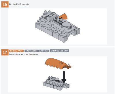

Clear visuals show step-by-step assembly.
TAKTO aims to remove the prior issues mentioned with visual tracking by using magnetic encoders to tell where the device is and the finger’s position inside it. Actuators are able to pull on the fingers themselves to add even further information to the user. Of course, none of this is too crazy, as we have seen similar projects before. Where TAKTO stands out is the extent of the support outside of a one-off hand tracker.
TAKTO.one not only holds general information about the project itself, but also an entire digital twin of the live device. This console can give you a visual of using the glove and general status information. Documentation on how to assemble one for yourself is presented in clean visuals, which should make the build process painless.
