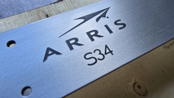

Home routers and cable modems are now extremely powerful devices, but they all suffer from the attention of their manufacturers’ design and marketing departments. Instead of neatly packaging them in functional cases, they impose aesthetics and corporate identity on them, usually resulting in a curvy plastic case that’s difficult to integrate with other network infrastructure. [The Eccentric Workshop] did something about this with their new Arris modem, by creating a new 19″ rack mount for it.
Unusually for such a device, the plastic case was easy to dismantle. There’s a PCB inside, and a light guide for its LEDs. A new lower-half case and light guide were designed and 3D printed, and the whole was then mounted in a 1U rack case. The special part of this hack perhaps lies in the front panel, a very professionally cut and laser etched affair complete with an Arris logo as though it were meant to be this way.
