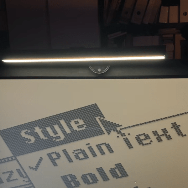

If you’re intending to work at your desk for long periods of time, good lighting is a must, as it can help stave off eye strain and mental fatigue. It was a desire for more comfortable productivity that drove [Jade] to whip up a monitor-mounted lighting system for her workstation.
The build uses an ESP32 to run the show, with a rotary encoder for manual control and firmware that allows the monitor light to be neatly integrated with Home Assistant. The light itself comes from light strips that feature both warm white and cold white LEDs. Simple MOSFETs are used to control the brightness of the LEDs and which of the warm and cold LEDs are activated at any time. Everything is wrapped up in a 3D printed housing that neatly sits on top of the monitor with the aid of a simple printed clamp. The LED strips also have a nice soft glow thanks to a strip of diffuser material that [Jade] snatched from an old television.

  1. With the diffuser close to the surface light spills out over a nearly 180 degrees which means light on the screen or in your eyes. Lighting spilling out into the house is the “in” thing since MTV, but has no place in productivity lighting. Nothing indoors lights up a work area like cross lighting by movable arm small flood lights over a desk, and a screen-less TV for light on the ceiling.
    If the diffuser was deeper into the fixture it would shade the light to a more limited area. Keep the diffuser as the zebra shadows of spots of light need taming.
  2. My desk is definitely too dark and I have researched methods to change it for quite a while. That’s why this build drew my attention. After a closer look it has one flaw that I’d like to avoid: light is distributed in a too wide angle. The flat surface of the diffuser scatters the light uniformishly 180° “above” (below, around) it’s surface. In practice one may want this angle to be 40°-60° so neither the screen below the lamp nor user’s eyes in front of it are exposed to light coming directly from the lamp.
