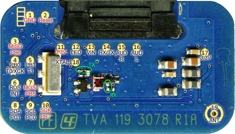

The Sony-Ericsson MMR-70 radio transmitter apparently used to connect to a cell phone and broadcast music. But the Walkman cellphones in question are a little bit old in the tooth, so one can buy the transmitter units for cheap on the resale market. What makes the transmitters even more interesting is that you can activate and deactivate the radio, change frequency or output power, and even send RDS station and song information.
It turns out (link in German) that the radios have an AVR ATMega32 microcontroller and a NS73 radio transmitter module, which can be entirely controlled over I2C. (Schematic here as PDF.) The units also have handy test points strewn all around. Once the test points were mapped out, one could completely ignore the on-board AVR microcontroller and control the FM transmitter module directly using the Raspberry Pi’s I2C outputs.
And that’s where [Manawyrm] stepped in. She wrote an I2C daemon for the Raspberry Pi that lets you control the FM transmitter via simple commands. All you have to do is solder up a bunch of test points, install [Manawyrm]’s software, write a batch script, and you’re on the air. For instance, this makes building a FM radio retransmitter for online streamed audio a one-day project. You can see his working example on youtube. Of course, you’ll want a web-based remote control interface to go with that.

  2. From the schematic, it would seem that SCK, MISO, and MOSI are brought out to test points as well. These are the ICSP pins (plus power and ground), so it’s likely that the micro can be reprogrammed.
    The schematic calls out a TSM 1-6 transmitter chip, while the article text says it’s an NS73 transmitter. Are these the same?

      yes, the mega32 can be reprogrammed. I did so, and I also have some sample code laying around.
      Andrey Chilikin did an excellent job labeling all the test points in his blog: http://3.bp.blogspot.com/-n_ohkJBPz-Y/U4kBKn4AZ4I/AAAAAAAAASc/p6EYkGonyuY/s1600/mmr-070-1024.jpg
      The transmitter is a NS731 (!). The 731 supports RDS as opposed to the 73.
      I do have datasheets for the transmitter as well as some .c code. Send me a mail ;)

        As someone else noted, all ISP-pins are available on test points.
