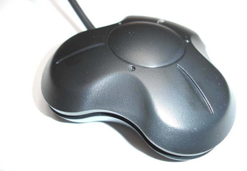

Instructables user [bkovac] was sick of clicking the terminal icon on his desktop whenever he wanted to launch a terminal window. Keyboard shortcuts aside, he figured the easiest way to take the tedium out of the process would be to launch terminal windows with a foot pedal.
He grabbed a pedal that he had sitting around in his workshop and took it apart to ensure the switch contacts were configured for his particular use. The wires were run to an Arduino which talks to the computer over serial using a Python script.
While the setup works just fine, it’s definitely not the most efficient or simplest way of getting the job done. In fact, we have seen other methods that are quite a bit simpler, though they lack the potential versatility of this particular modification.

  1. Way too much time and expense…
    Like the one in the second link, why not just pull the PCB out of a USB keyboard and hook the switch(es) up to a regular or esoteric keystroke?
    Key re-mapping / macro software can be used too.
    What’s the advantage of doing it this way?!

  4. Why not hook the switch up to the serial input lines, like CTS or DSR? Have Python monitor the line and do something when the line changes state.
    No Arduino required.

  16. A move to a Teensy would, arguably, have considerable advantages besides those of size: Since the Teensy is a direct USB device, not a USB-serial-converter, you can configure it to directly act as a USB HID device, and generate arbitrary keystrokes. Boom. Works without any software(aside from a HID keyboard driver, which everything has). Want more buttons, or macros, or something? it has enough I/O and onboard memory to allow all sorts of individual keys, or keystroke sequences, to be stored and played back in response to environmental inputs.
