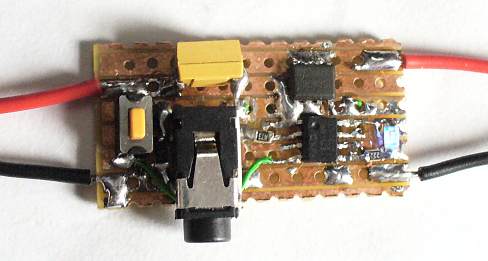

  4. I added a ‘shutdown timer’ to my Microvision ShowWX pico projector a while back, so I can watch a big screen in bed and not worry about the projector running all night :)
    http://www.haku.co.uk/pics/PicaxeProjectorPower.jpg
    I soldered an SMD Picaxe 08m2 and an SMD p-channel mosfet to some stripboard, a p-channel was chosen because I wanted to control the +5v line as controlling the GND might have caused issues with the GND line coming from the VGA connection. The largest component is the SMD mounted stereo headphone socket for programming the Picaxe. Not the most tidy of soldering but worked first time (and still works to this day) without needing any modifications.
    The single button controls how long you want the power to stay on for, press it 5 times and it blinks back 5 times to indicate the number of presses then switches output power off after 50 minutes, the LED then blinks once a second to show it’s not providing power to the projector. Press & hold it for 2 seconds and it cancels the countdown and stays on permanently.
    The blue SMD LED is PWM controlled and found I had to keep its brightness right down or it became distracting in the dark.
