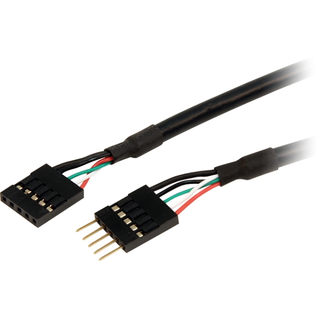

got a lot of love for this… would love to see a corner version also!
Here is your fix for multiple rows:
http://www.govgroup.com/images_products/2473064_big.jpg
