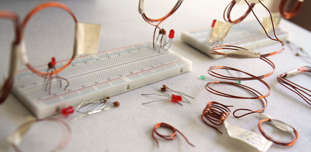

The ‘wire receivers’ photo shows a) coils that were ‘tested’ that haven’t had the enamel removed from the ends, andb) at least one would not be of any use at all as it is wound to counter itself (large one right of center). Sample primary ring they show is not unfeasible, but would require a hefty transformer to feed it, which is not shown. The first vid (GIF at top of page and vid lower down– Higgins tree) defies belief for a number of reasons, the principal one being that the ornament would have been in the reasonably uniform part of the field long before touching a branch, and should have been lit it it was real. Ditto for the vid already dissected. Also, doing a few calculations for air coupled transformers doesn’t lend a lot of support to the concept as shown, even with LED’s.

As for your question of the wire receivers… a) the enamel is sanded off and b) the polarity of the winding is of little consequence due to the fact that it’s magnetically coupled. We’re not going to show all of how we did it with the power supply, there’s some IP there we’d rather not show. Anything else we can take video/images/etc.

One of the coil designs would cancel out any power transmission.
The prototype coil with larger copper tubing shows lack of knowledge of wireless power transmission.
The container of through hole capacitors illustrates that they have no clue what the power requirements are, and

Wow, I don’t even know where to start with your comments…
Coil design: Don’t know what you’re referring to. A coil is simply and inductor. For resonant inductive coupling if you operate at the resonant freq, power transmission is completely feasible.
Metal Pole: Yes, there is a metal pole. As long as it isn’t adjacent to the coil it doesn’t affect the resonant frequency. We’ve tested artificial trees with our setup and there isn’t an issue.
Camera Flare: Please be more specific. The frosted bulb images are 100% legit power transmission. The commercial was staged with an empty bulb as we didn’t have everything together back when we taped it and that video was supposed to be our intro.
