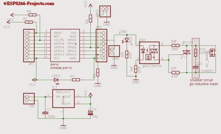

Called the MPSMv2, the core of the project is the ESP8266 module. The dev board itself can support anything with GPIO pins, whether it’s an Arudino, Raspberry Pi, or anything else with those features. Flashing the NodeMCU firmware is pretty much all that needs to be done in order to get the device up and running, and once you get the device connected to your WiFi you’ll be able to control whatever appliances you want.
The device uses a triac to do the switching, and is optically isolated from mains. Be sure to check out the video after the break to see the device in action. All in all, this could be a great way to get started with home automation, or maybe just do something simple like build a timer for your floor lamp. Anything is possible!

Opto-isolated TRIAC is fine and dandy, but there is no fuse, so if you overload it, you have a cooking TRIAC in your junction box …

Also, the datasheet rates this triac at only 1 amp.
MOC3041M Zero Crossing Triac
Peak Repetitive Surge Current = 1A
This thing is going to get really unhappy when you plug your 15 amp motor into it and it’s embedded in your wall outlet.
No, he is using a MC3041 to drive a BT137 which can handle 8 amps continuously (if properly heatsinked).
And the MOC3041 can not handle a 1 amp load, “Peak repetitive surge current” is what it can handle for 0.0001 seconds at every 60Hz cycle before getting (possibly) damaged. The continuous load limit is far less than 1 amp.
You need to learn how to read a datasheet and understand the terms – without an understanding it won’t do you any good.

Well, look at the silkscreen.
http://4.bp.blogspot.com/-CAO-4rqzSJk/VS-Hr9b__xI/AAAAAAAAAi8/2wUtBKiy1n0/s1600/0_1%2B-%2BESP8266%2B-%2BWIFI%2BMPSW_v2%2B-%2BSCH%2B-%2B0_1.jpg
It calls out a MOC3041M on the silkscreening. One can use a MOC3041 of course as they are the same form factor.
But yes, 1A is the absolute maximum, peak value for the MOC3041M for a brief amount of time. Even the MOC3041’s 8A maximum, temporary rating is unsuitable as a peak for a typical 15A US mains.
Silkscreen should read schematic.
If you can tell me the relation between MOC max or peak amps values and the switched power done by the MAINS BT137 Triac I will be more than happy to hear….

Ahh, my late, late night read of the datasheet for the MOC3041M, which the schematic initially? called out but then was changed to a MOC3041 had the mains load being carried by the MOC3041/M triac, not the BT137 triac. Good catch. The triac should still be able to handle 15 amps, not just 8. And I agree, I don’t see any heatsinking.
Yep, this is the version that can handle 1A rms
http://www.vishay.com/docs/84132/vo3020.pdf

It’s a great idea but a shame it isn’t laid out correctly, The traces on the low voltage side of the opto-couple are too close to the mains voltage and also the trace from resistor R8 to the opto is too close as well.

I don’t know where do you see low voltage traces close to mains voltage. Trace from R8 to the opto is 2.64. How far do you think it should be to meet your standards? Conformal coating is telling you anything?
You can google PCB creepage clearance or creepage distance.
The TLDR; is –
“In high voltage systems clearance according to EN60065:1994, 3 mm is required for Class I and for Class II, 6 mm is required in mains operated systems (240VAC)”
However, experience tells me that this very minimal standard is not good practice. Modelling for 240V will only cause problems with the first over voltage transient or spike.
In the case of an opto-couple my ‘rule of thumb’ is for the min to be the distance between the pads on left and right rows of pins. ie nothing under the opto at all apart from the pads connecting the pins.
For a TRIAC I bend the middle pin forward 0.1″ – 0.2″, this is often done commercially and you can even buy them pre-bent.

The problem is that the triac may dissipate more than 15W when using it at 10A, which requires a good heatsink and ventilation. That’s a lot of overkill if you just want to control a 6W LED lamp.
If the device does not have it owns fuse/breaker and relies on the upstream one, it had better be able to handle the full rated current without catching fire.

“If you can power the logic side with some +5V derived from mains, there is no point keeping the optocouplers, right?”
WRONG!
Semiconductors can fail, and when they do, they often fail in ways that make conduction paths that otherwise should not exist. Mix that with high voltage power and you’ve got a recipe for disaster.
Optoisolators are designed so that even in failure they are capable of holding back thousands of volts. UL registration demands no less. The same is true of isolated power supplies.
If you insure that your HV and LV systems are completely separate, and joined only by UL registered galvanically isolating components, only then can you be prepared to say that the logic portion of your system is safe. And doing that maybe won’t make fewer things capable of going wrong, but at least fewer things capable of spectacularly dangerous failure.
if the only connection is via RF it is already isolated there is no point in an optocoupler
You also need to insure that the hot line is completely isolated from the neutral line other than via the intended switching and power supply paths. Insuring that is a hell of a lot easier when you use registered isolating components to do it.
why? it doesn’t change anything on the mains side
Because a failure of the sort I have described will not be current limited. You’ll likely start a fire.
A hobbyist should not screw with a Triac on house wiring if it will be “permanently” installed in a junction box. Make an adapter that plugs into a socket on the outside so that it is clear it is not a normal outlet. If you have to homebrew something like this use a good relay or contactor with a UR approval. AND read the spec on it thoroughly.
Right! I would fear fire hazard more than potential for electric shock though.

Very nice. It’s similar to my Toast-R-Reflow power board (though that one has two channels and uses BTA-20s).
The layout looks good too, but I’d recommend for version 2 that you increase the creepage distance between the HV and LV – particularly with regards to the LED. My own habit is to place an actual “border line” on the silkscreen. Nothing is allowed to span that line except for galvanically isolated components (isolated power supplies, opto-isolators, etc).
http://www.geppettoelectronics.com/2015/03/high-power-system-design.html
Nice Article. Just for the records, LED is placed at 6mm distance.
Maybe it just looked closer in the picture. That’s probably my bad.

Zaprodk bitches about the absence of a fuse — which is clearly explained to be located on a separate power entry board.
Waterjet, who seemingly has no concept of how a basic opto-isolated diac-driven triac circuit works, chimes in with useless blabber about insufficient current ratings of the *optoisolator* — seriously? If you’re going to throw stones at someone, perhaps you could verify that you have somewhat of a clue of what you’re talking about?
Rob complains that the board isn’t laid out for 240 VAC — yet I see ample clearance between traces. Other users complain that the board isn’t designed to drive a full 15A load, yet most commercially-available, UL-listed dimmers I’ve seen are rated for 800W or less. The Lutron dimmers I paid almost $30 a pop for only do 600W.
I don’t know who all of you people are, but stop being ridiculous. This guy made an ESP8266-based TRIAC switch, and gave the design away for free. He has ample warnings on his web page about this project. I encourage anyone who wants to use this design to research the subject thoroughly to make sure they understand what they’re doing.
A few people made some useful design suggestions. I like the Power Integrations LNK switch suggestion for power. I’d also recommend looking at the SR086, which does the same thing — but it’s inductorless! That’s the chip I’m using for my ESP8266-based WiFi dimmer.
It’s good to see a snubber on the design (that’s often omitted on DIY designs I’ve seen). There are a few TRIACs that are designed to commute highly-inductive loads (“snubberless” is the marketing term I’ve seen) — may worth looking into them to reduce the BOM.
TJ may also want to mention on his project page that without a choke, the TRIAC will dump out a ton of EMI (that’s why most commercial dimmers have to have a choke in series with the load to be able to get FCC certification).
