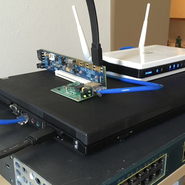

So if you’re in the US and you need a router, what can you do? [Noah Bailey] is here from Canada to point out that almost anything (within reason) in computer terms can be made to perform as a router.
The piece is really a guide to setting up a Linux router, which he does on a small form factor PC and a hacked-together assembly of old laptop, PCI-express extender, and scrap network kit. In its most basic form a router doesn’t need the latest and greatest hardware, so there exists we’re guessing almost two decades of old PCs just waiting to be pressed into service. Perhaps it won’t help the non-technical Man In The Street much, but maybe it’ll inspire a few people to save themselves a hefty bill when they need to connect.

  2. Nice! I kind of feel that if you want to get into the nuts and bolts of configuring Linux to be a router manually you probably don’t need the guide though.
    A more apt replacement for a “typical consumer” router might be a router-distro. I like OpnSense which is a fork of PfSense, which is still pretty popular too. I’ve heard good things about DynFi which is forked from OPNSense but with my OPNSense setup already working well I’ve had no reason to switch. Of course, those are not Linux. They are FreeBSD under the hood. Supposedly that is better for router use… I don’t know enough to say why. If you do want to stick with Linux I see that OpenWRT can run on a PC. I don’t know how hard it is to get installed on a PC as I have never done so but if you are used to inexpensive Chinese routers… it will give you a very familiar interface since most of them are based on it. And no, that is not meant to say it is “cheap”. OpenWRT make a very nice router OS.
    The router with the bad WAN port was a good find. You don’t need a WAN port on your access point for this sort of configuration. But… a thrift-shop find is probably not going to be the latest WiFi spec. In the more populated areas… those original 2.4GHz WiFi channels can get pretty crowded! If you aren’t on a very strict budget I wouldn’t skimp on the WiFi. The other alternative… just stick a WiFi card in your computer. Or I guess a USB WiFi adapter if it’s a laptop… (USB network devices have gotten much better but I had so much grief troubleshooting them back in the day…) Anyway, your router distro should have the ability to use a WiFi adapter built into the machine and be it’s own access point. Just make sure that the chipset is supported BEFORE you make a purchase you cannot take back.
    Building your own router this way can have some advantages. For example… run your own VPN server. Now you can access your LAN at home when you are away. Yes, you can do this on many OpenWRT consumer routers… but it can be harder to get it working. The one time I managed… the router bricked itself a couple of days later. I think they justs aren’t made for that sort of thing and it burns up the NAND. You can also set up ad blocking. Or if your internet is less than fast, maybe caching. Many many years ago, back in College I used such a PC based router to share dialup internet access with my roomates so we could all be on at the same time. I had it caching all the non-ASCII files such as images… despite being mere dialup, if someone else had visited the page before you it would pop up instantly!
