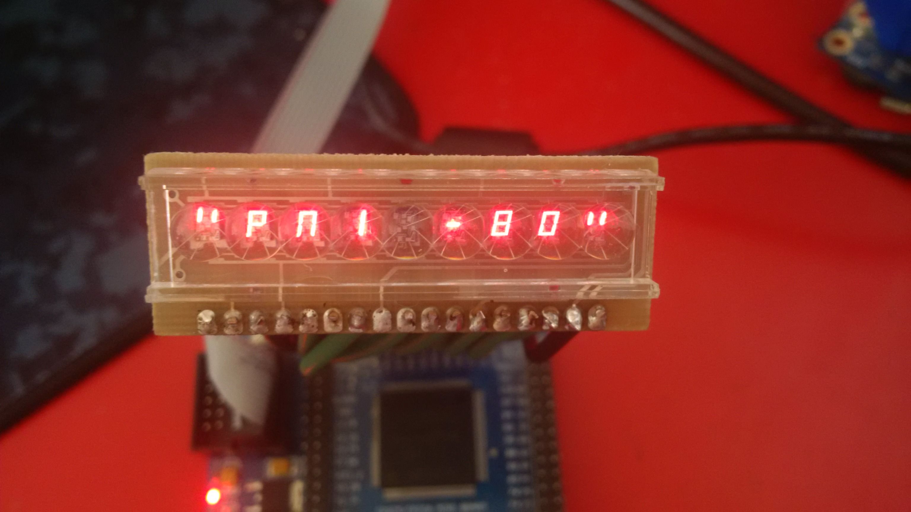

The computer further included a VQD30 display, manufactured in the former Germany (Deutsche Demokratische Republik). This was a functional equivalent of displays NSA1198 or CQYP95 – 9 seven-segmented common cathode displays. Input data was provided by a keyboard which was built as a 3×9 matrix. Both of these peripherals were driven by a circuit based on the PIO 8255. Port A outlets (PA0-PA6) controlled individual segments (anodes) through the drive transistors. Lowest four bits of port C were decoded by a circuit MH1082 (equivalent to 74145) to code 1-from-9, which was used to select positions, and simultaneously activating the columns of the keyboard. Keyboard lines were connected to bits PC4-PC6.

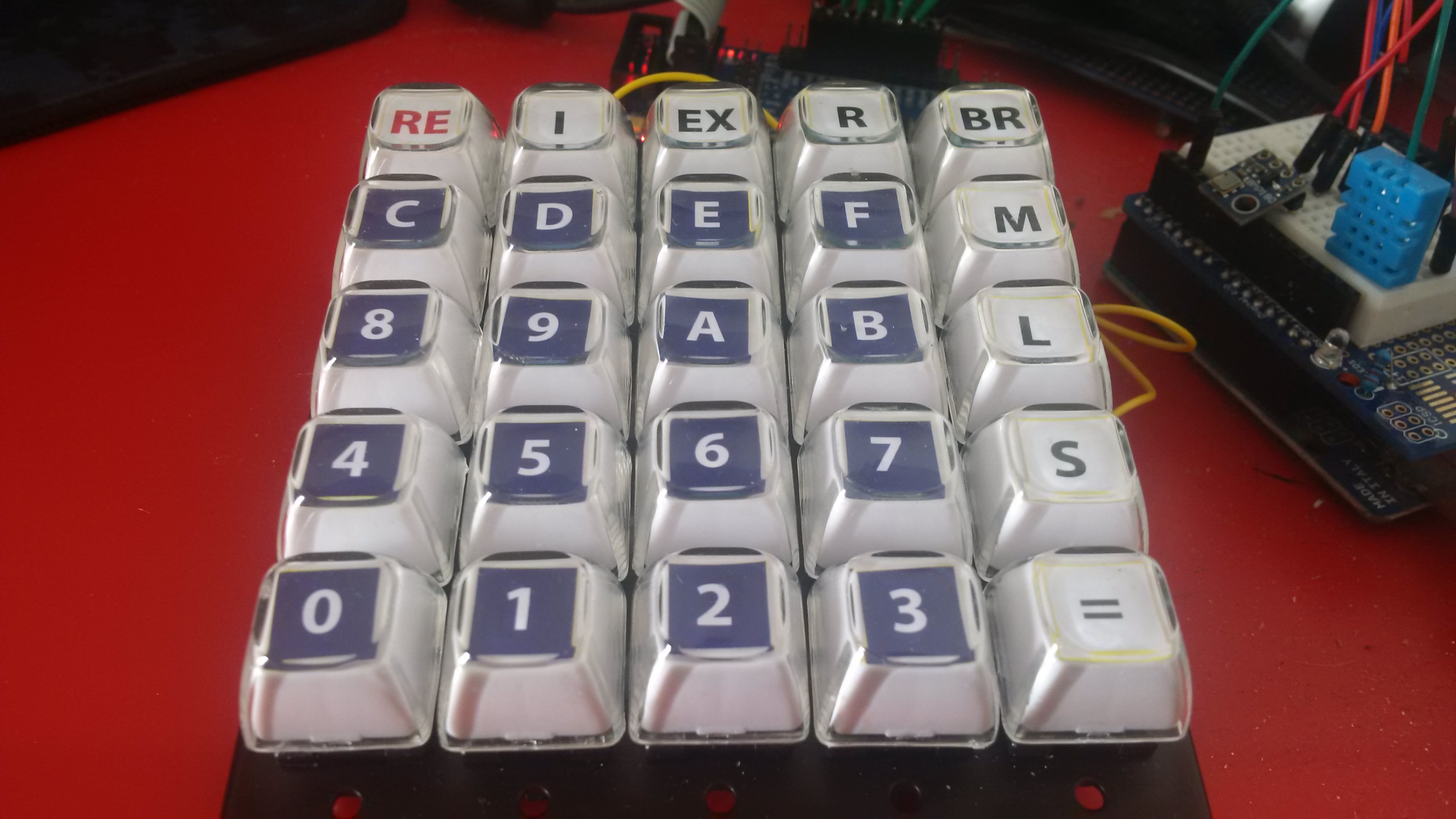

retro-computer-on-a-chip-tableThe keyboard was composed of 25 keys arranged in a 5×5 matrix. Inside, however, it was wired differently. Two keys (RE and I) have led directly to the inputs of the processor (RESET, respectively INT). The remaining keys (0-9, A-F, EX, R, BR, M, L, S and =) have been wired in the already mentioned 3×9 matrix as shown here.

I connected a keyboard as a 5×5 matrix, not in an original 3×9; recoding into a form suitable for the PMI is being handled inside the FPGA.
The display is connected through resistors straight to the FPGA, and again, all logic and remapping into a form suitable for emulation is being done inside the FPGA.
