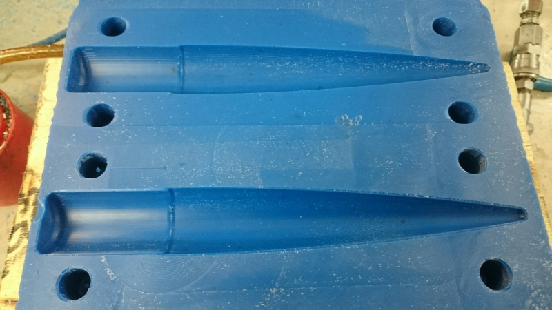

It’s great stuff for trying out toolpaths. You can run very high chip loadings.
I ran this http://www.caswa.com/images/forums/mould_small.jpg at 50KRPM 3mm, 2 flutes, 3mm DOC, 2m/min…
