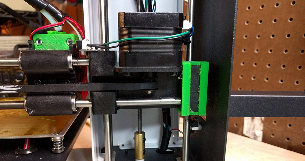

A New Bed
The stock bed on the MP Mini is an aluminum clad PCB. For the price, it’s an awesome achievement; you don’t actually need a glass bed to print on this machine – all you need is a little bit of masking tape. That said, aluminum bonded directly to a PCB isn’t going to stand up over time, and it’s a good idea to put a piece of glass down.
This is a problem for the MP Mini. The bed leveling adjustment only has so much play, and the mount for the Z axis limit switch is built right into the frame. Some sort of modification is necessary to raise the print head up, and for that, a simple print is all you need.
[Sumpy]’s Glass Bed Spacer is precisely what you need if you want to put a piece of glass on the bed. It effectively makes the Z axis carriage taller, making it hit the limit switch higher than it usually would.
Clip this spacer onto the carriage, and you can raise your bed up 3/32″. While this is a great print, a better MP Mini Glass Bed Spacer would make use of Thingiverse’s Customizer. Being able to input the thickness of a sheet of glass, a glass and PEI sheet, or any other build platform stack up and get a perfectly-sized adapter would be great, but unfortunately the Thingiverse community doesn’t place any value on releasing the original design files for a part. That’s just another way Open Source reduces workload and effort duplication, kiddos.
