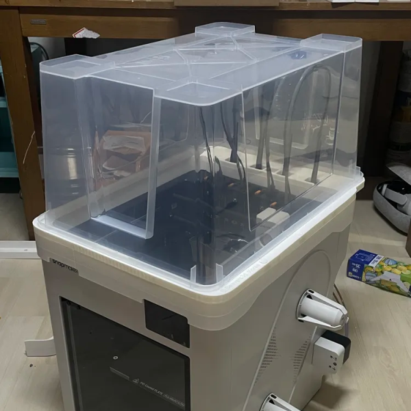

The Snapmaker U1 3D printer is an impressive machine for the price, but [Beaver Works] found the optional factory-offered top cover a wee bit expensive for his tastes. The solution? 3D print a fixture and use a clear 45 L Samla storage box from IKEA as an effective and affordable cover for the machine.
Why a cover?  A cover helps retain heat and block drafts, which can help improve print quality. A cover also keeps the machine’s insides dust and debris-free, not to mention serving as a decent barrier to curious fingers or paws.
This is a great use of an off-the-shelf product that performs at least as well as any bespoke solution. The nature of printer enclosures makes them trickier than one might think, with the size and weight of materials often driving costs up for something that seems relatively simple in concept. Getting one by 3D printing the fixtures and purchasing the bulky part locally and affordably is a great alternative. IKEA even sells the box’s lid separately, so one can buy just the box and isn’t stuck with an unused lid afterward.
Integrating off-the-shelf components into a design is often risky because much of it is outside the designer’s control. Availability can change, and a manufacturer might alter dimensions or design elements without any notice. But IKEA’s storage products are pretty well standardized and work really well for this purpose.
On the off chance you need a design tweak, [Beaver Works] has provided STEP files for the 3D-printed parts, something we always love to see.
