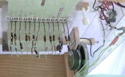

Carbon composition resistors in music player
These are often referred to as “old” resistors and were widely used in the 1960s but with the introduction of other types of resistors, and their relatively high cost, they’re used less now. They consist of a mix of ceramic powder and carbon bonded together using resin. Carbon is a good electrical conductor and the higher the concentration of carbon in the mix, the lower the resistance. Wires are attached to the ends. They’re then coated with paint or plastic as an insulator and different colored stripes are painted on to indicate the resistance value and tolerance.
The resistance of these carbon composition resistors can be permanently changed by long exposure to high humidity, being overstressed by voltage and by overheating when soldering. Tolerances are 5% or greater. Given that they’re basically just a solid cylinder they have good high-frequency characteristics. They also have a good ability to resist heat overloading comparable to their small size and so they’re still used in power supplies and welding controls.
However, their age didn’t stop me from using a bag of them I’d bought from a second-hand store in order to make up the different resistances I needed for a 555 timer music player. That’s my kludge you see in the photo above.

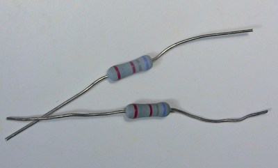

Metal oxide resistors
This is much the same a metal film resistors except that the metal is often tin oxide contaminated with antimony oxide for resistance. This gives it a better performance than either carbon film or metal film in terms of voltage rating, overloads, surges and high temperatures. While carbon film resistors are rated for roughly 200C and metal film, 250-300C, metal oxide works with 450C. However, they have inferior stability properties.

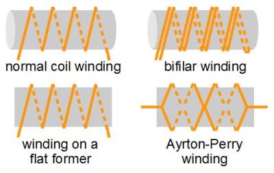

Wire wound resistor windings
Since the wound wire is basically a coil, they have sufficient inductance and capacitance to have poor properties at high frequencies. To reduce or eliminate this, other ways of winding it are done such as bifilar winding, winding on a flat former and Ayrton-Perry winding as shown in the illustration.
In the case of bifilar winding, induction is eliminated but capacitance is high. By winding on a very thin flat former the wires are close together and induction is lessened. And with Ayrton-Perry winding, since the windings with current in opposite directions are close to each other, self-induction is lessened and capacity is minimized as the potentials are the same at the intersections.

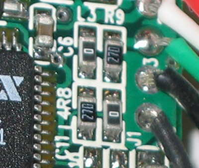

SMD resistors
SMD resistors
Most Surface Mount Device (SMD) resistors are of this type. The film in thick film resistors are around 1000 times thicker than in thin film resistors and thick film resistors are the least costly resistors on the market. Thin film costs much more than thick film.
Thin film resistors are made by sputtering nickel chromium (usually) onto an insulating substrate. This is then etched using photo etching, abrasive or laser trimming. Thick film resistors are made using a screen and stencil printing process. The film is a mix of a binder, a carrier and a metal oxide. Final trimming is done by an abrasive or laser trimming.
Thin film tolerances are as good as 0.1% and TCR is 5 to 50 ppm/C. For thick film tolerances are as good as 1% with TCRs of 50 to 200 ppm/C. Thin film also has lower resistor noise than thick film.
Typical applications for thin film are wherever high precision is required. Thick film has application in pretty much any electrical device — some PCs contain over 1000 thick film SMD resistors.

  6. That Ayrton-Perry method of winding wire-wound resistors is ingenious. I was only aware of the bifilar winding. Want to reduce capacitance? Make sure the metals which come closeby are at the same potential.
