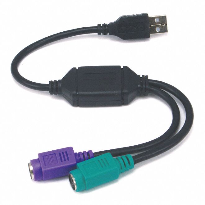

Trackpad with Arduino PS/2-to-USB converter
Old laptops are easy to find and many have a trackpad with a PS/2 interface hardwired into the guts of the laptop. [Build It] wanted one of those trackpads for use in the DIY Raspberry Pi laptop he’s working on. But the Raspberry Pi has no PS/2 input, and he read that a PS/2 to USB adapter wouldn’t be reliable enough. His solution? Wire the trackpad to an Arduino and have the Arduino convert the trackpad’s PS/2 to USB.
After removing a few screws, he had the trackpad free of the laptop. Looking up the trackpad’s part number online he found the solder pads for data, clock and five volts. He soldered his own wires to them, as well as to the trackpad’s ground plane, and from there to his Arduino Pro Micro. After installing the Arduino PS/2 mouse and the Mouse and Keyboard libraries he wrote some code (see his Instructables page). The finishing touch was to use generous helpings of hot glue to secure all the wires, as well as the Arduino, to the back to the trackpad. By plugging a USB cable into the Arduino, he now had a trackpad that could plug in anywhere as a USB trackpad. Watch [Build It] put it all together step-by-step in the video below.

    1. “and he read that a PS/2 to USB adapter wouldn’t be reliable enough. His solution? Wire the trackpad to an Arduino and have the Arduino convert the trackpad’s PS/2 to USB.”
      1. That’s a pretty dated article and full of irrelevant information. It’s true that many PS/2 devices were both USB and PS/2 and the adapters that came with them were simply wiring adapters. Obviously those won’t be of any use here. A commercial PS/2->USB converter made for using a PS/2-only device on a USB machine is exactly what he reproduced with an Arduino. I’m not sure why the Arduino is any more useful – but I’m sure it was fun to do and that’s important too. Adapters (https://static.grainger.com/rp/s/is/image/Grainger/14C376_AW01) can be found for under $6 and they should work fine.

    Funny thing would be is if the touchpad supported USB from the get go. A lot of USB/PS2 input devices made over the past 2 decades do. So long as you hook up the power and data pins to the right pads, the devices recognizes it is on USB and switches from PS2 to USB mode. That is how a lot of the existing PS2 to USB adapters on the market work, they are simply dumb pin converters and the device being plugged in auto detects what bus it was just plugged into and switches into the appropriate mode.
    1. Double checked that, Unfortunately, the touchpad used was exclusively PS/2 as the laptop was over 7 years old however I did take a look at using the PI’s GPIO headers but ultimately I scrapped that idea because I intended to use the trackpad on a few different devices some of which don’t have available GPIO headers
