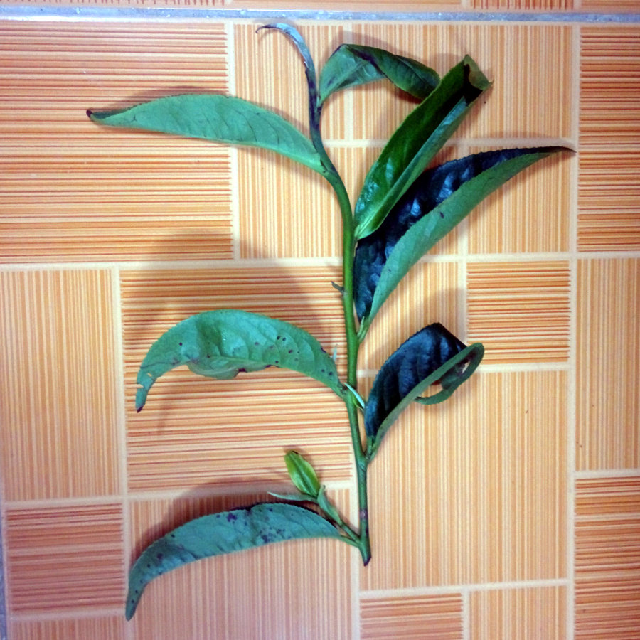

Not disease or rot — this is normal oxidation after bruising a leaf
If you do manage to buy fresh tea, you’ll now have one of two things: hand-picked light green tea leaves, or a bundle of branches that look like someone took a hedge cutter to a tea bush. While the former is more convenient and associated with a higher quality product, the latter is more interesting as you can separate the different parts of the plant into different types of tea.
There are basically three parts of the plant you are interested in: the old tea leaves, the young tea leaves, and the silvery tea buds. The soft, light green freshly sprouted leaves are the most useful part, and are used for making good quality tea, especially oolong. Oolong tea is bruised, then partially oxidized. We’ll call these leaves ‘Grade A’. The large, dark, and brittle older leaves are less desirable. They can still be used to make tea, but are harder to work with and have less flavor. These are better to use to make black tea, which is crushed, then more heavily oxidized. We’ll call these leaves ‘Grade B’. The small, silvery buds are dried with barely any processing to make white tea.

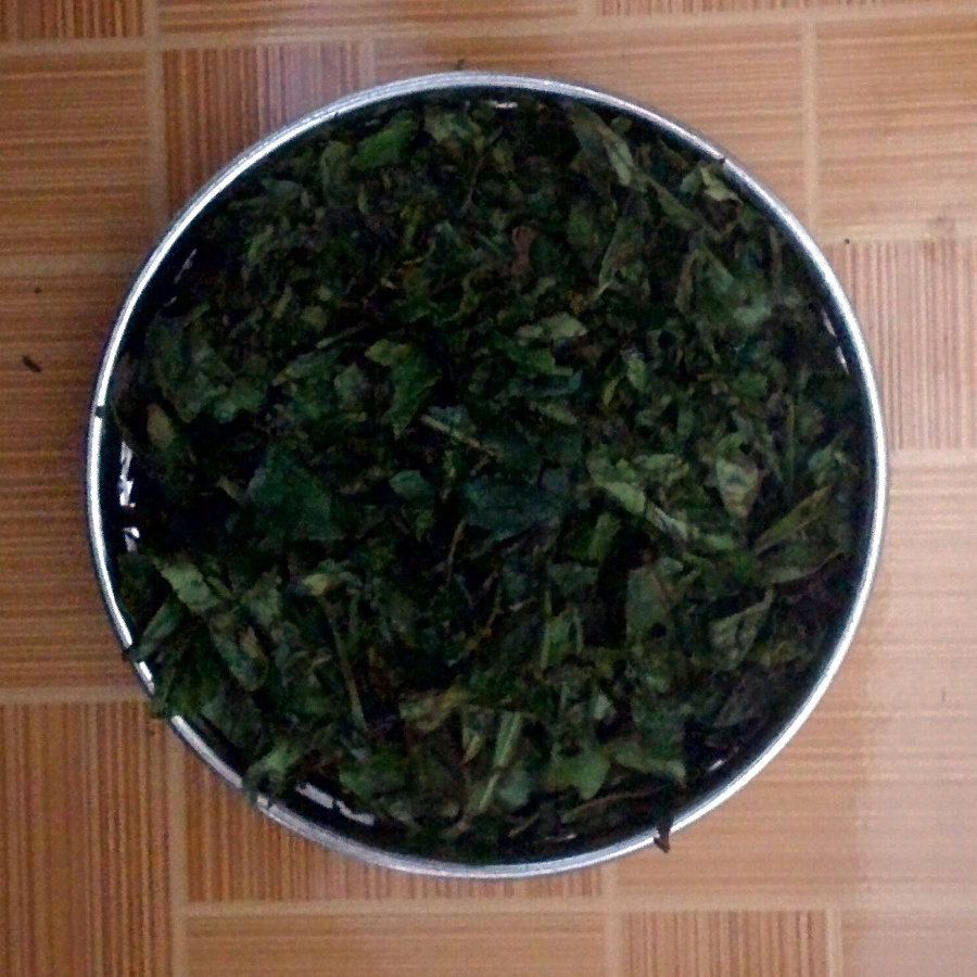

For the Grade A leaves, place a few between your hands and rub your hands together until the leaves are throughly bruised. Then set these aside and repeat for the rest of the leaves. They will look roughly like this:
Cover them, for example by placing them in a pot with a cover, and set aside indoors at around 20-30 °C. How long you oxidize them is up to you – less makes the oolong tea more like green tea, more makes it closer to black tea. We decided to make an oolong tea closer to black tea, so left it for two days. When finished, you can see the oxidized leaves have browned compared to the bruised leaves.
