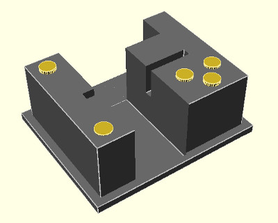

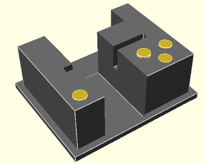

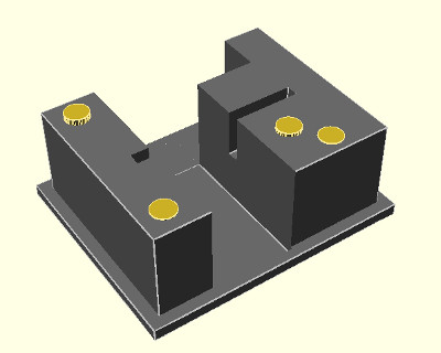

Oozing PLA is my spirit animal, so my mind immediately ran with the idea of using 3D printing to produce “keyed” card readers for ATMs. Creating a custom reader like the owners of this machine have done is an excellent first step, but it’s still a static design that can be accounted for eventually. What if, instead of printing out identical card readers for all your ATMs, you made each one unique, making it nearly impossible to anticipate?
The technology is easily imagined. With a parametric CAD tool such as OpenSCAD, the surface of the core card reader design can be augmented based on a randomized seed. Small geometric protuberances could be procedurally generated, and a new reader printed for each machine. New readers could even be generated and printed regularly in high value markets where skimmers are more common.
As a simplified example, I wrote a quick OpenSCAD script that randomizes the number and vertical height of several “pins” on the face of the card reader. Each time a new STL is generated for printing, the layout of the pins will be different. Such an unpredictable surface would make it harder to get a tight and flush fit with a skimmer, making it more difficult to conceal.
A fully realized version of this script could make more drastic changes to the reader, fundamentally changing its geometry each time the STL was generated; making adaptation all but impossible. Imagine a thief coming to attach their skimmer, only to find that the reader has changed into an oval since the last time they were there.

  9. Take that same script, wrap the outer shape in a hull(). That way criminals can’t make a mating surface that assumes a superset of the pegs.

  29. As far as the author’s plan with the special pins, wouldn’t you notice any skimmers when you come to install the latest permutation? So you could just pull it off. So you wouldn’t actually need the pins at all.
    Meanwhile our skimmer crook just alters the skimmer so it doesn’t attach to any of the pins. He just glues it on the flat bits instead.
    It’d be like using 512-bit cryptography in your burglar alarm, then a thief just comes and fills the bell box up with expanding foam. Or hits it with an axe. Some problems aren’t best solved with 3D printing! Actually, most problems.
