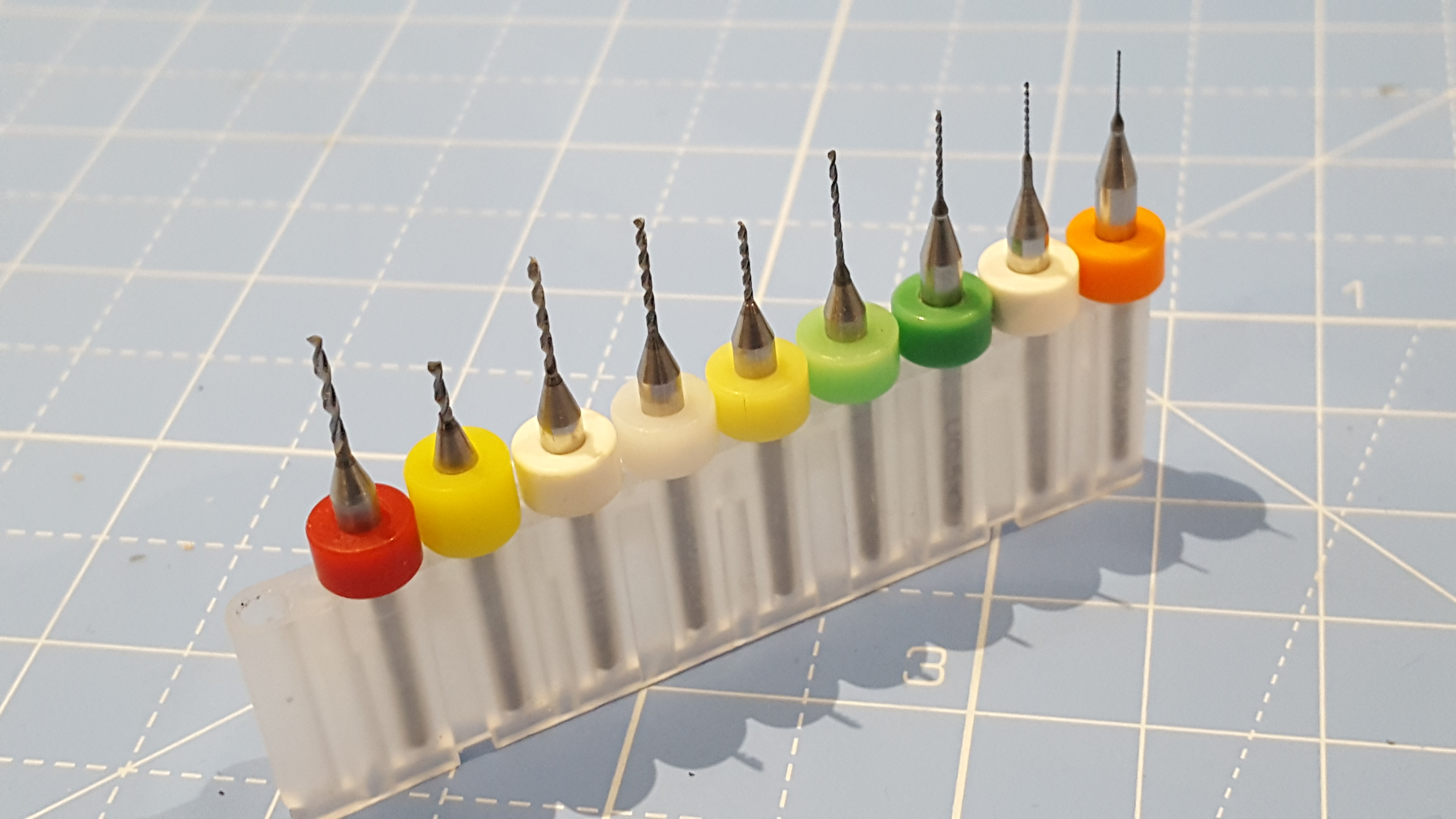

The Bits

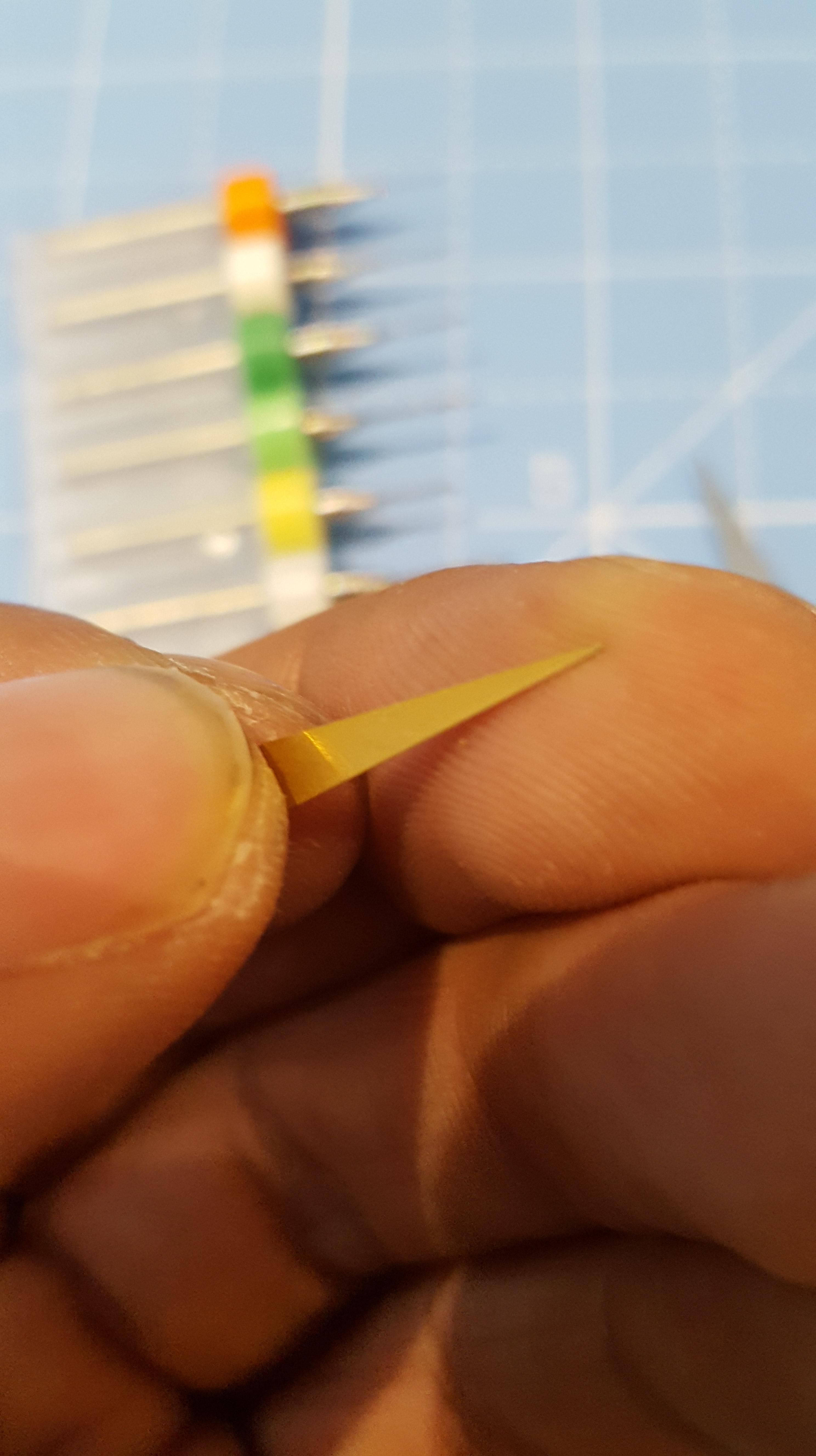

With the machine ready, we need to get the right tools for milling PCBs. The most important of these is the engraving bit, responsible for committing all the actual traces onto the PCB. This bit needs to be sharp so it actually cuts as opposed to tear the copper and of course it also needs to be fine enough to mill any tiny footprints or traces. After a lot of experiments, I’ve got the best results using generic 0.1 mm V bits from eBay. These are cheap and reliable enough for about 8-10 medium sized jobs. However, the V profile does pose a challenge when specifying its cutting width in software, as the deeper you go the wider they cut. This can be tuned via some trial and error.
Next, we need a few drill bits for drilling through-hole component mounts and vias. Every different hole you specify will need a manual tool change, so its best to simply stick to a single 0.8 mm – 1 mm bit which should be suitable for most things. I would recommend buying this set of cheap drill bits.
The last bit we need is the End mill, responsible for cutting out our board from the larger PCB clad. A 1-2 mm End mill does the job nicely.

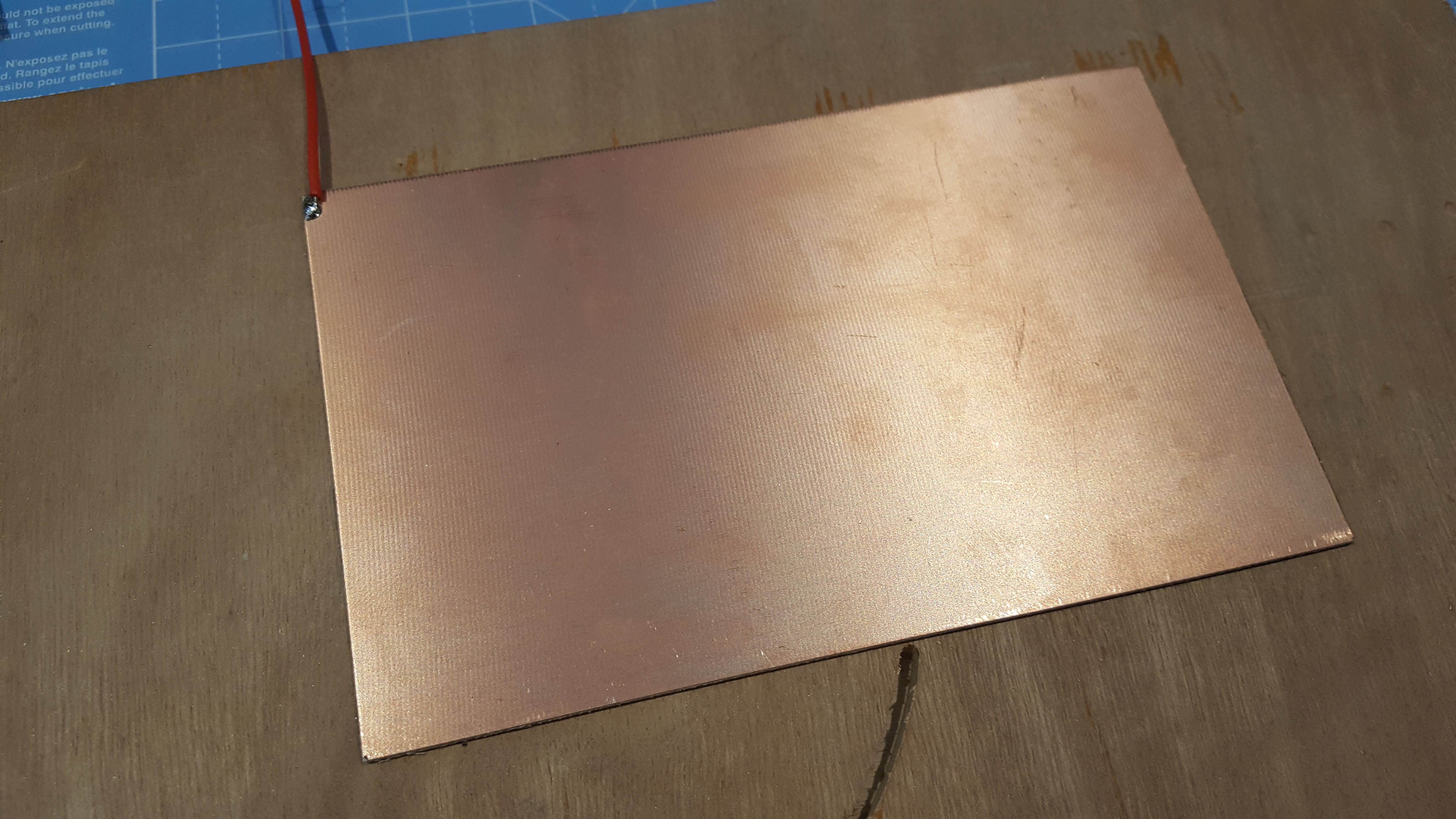

Apart from the above essentials we also need the actual PCB clad, I’ve found the generic, cheap, single sided ones on eBay are terrible, they crumble like biscuits when being cut. All the better ones seem to be double sided, in either case I had to experiment with a few different suppliers before settling with one I liked. Sourcing quality copper clad seems to be a topic that hasn’t been settled throughout Hackaday’s history.

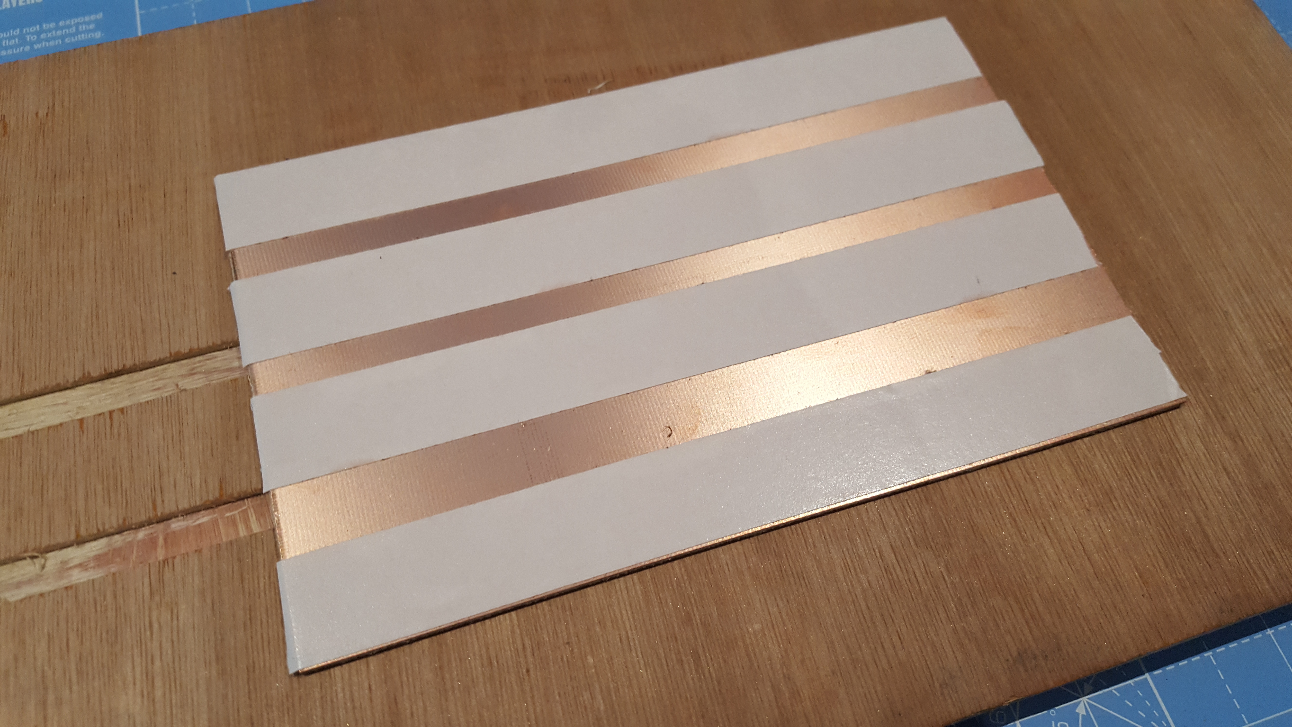

The biggest challenge in this DIY process is getting a correct and consistent cutting depth. These V-bits yield a wider cut the deeper you go, effectively robbing you of precious engraving resolution. If you do not tune in just the right depth, some traces will come out too thin and frail. The key to success is to experiment with a few cutting depths and most importantly probe the PCB to compensate for any variations in the height across the clad.
To tune the right cutting depth, I put together a simple test design consisting of breakout board for the super tiny DFN-8 footprint. The trace size on this board is as small as my designs would go. Next I tried a few different cutting depths and eventually found one with reliable results for these thin traces. I use a cutting depth of 0.8 mm with a 0.1 mm V-bit.

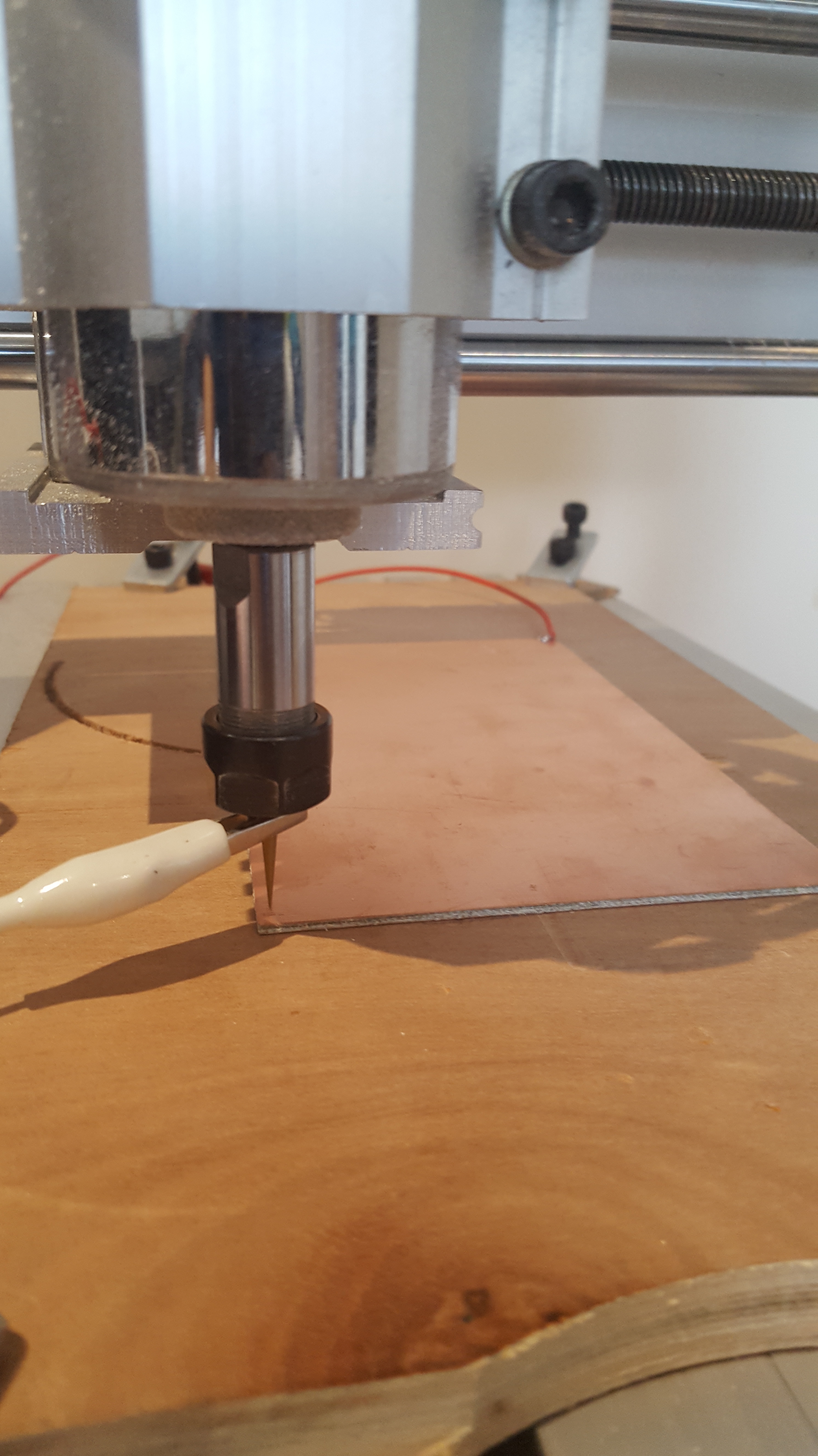

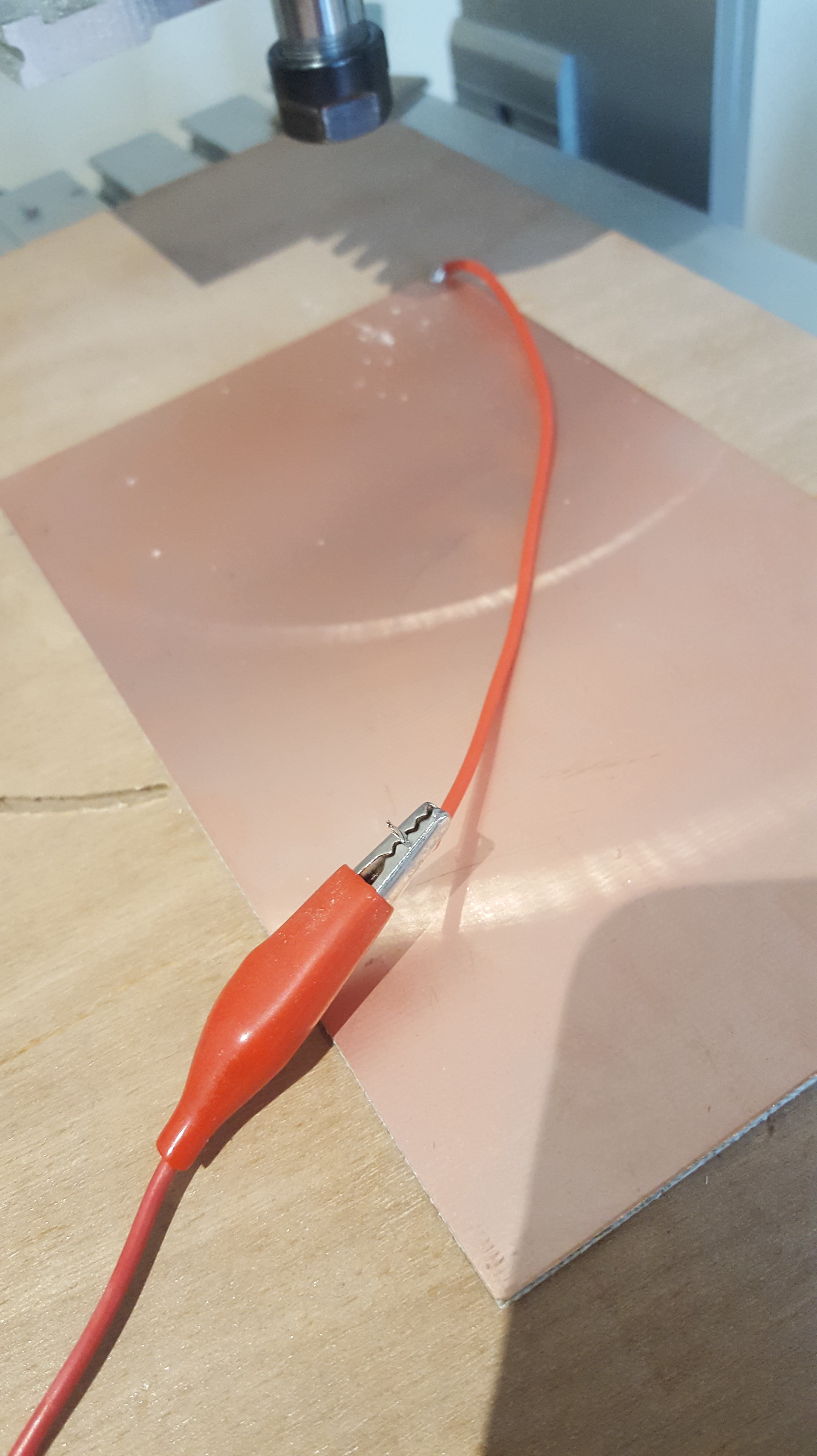

Preparing for Auto-Leveling
The auto-leveling process is set up in software and simply consists of a probing routine before milling. All we need to do is to solder a scrap wire to a corner of the PCB clad, and fasten it to an ideally flat piece of scrap wood using generous amounts of double sided tape.
Once this is complete, the wood is secured to the CNCs work area and the milling bit is secured in the chuck. A pair of crocodile clips are attached to the wire soldered on the PCB and the milling bit, completing the probing setup. The idea is to build a map of the height variation of the PCB, and if the PCB is not completely level, the mill will actively compensate for the error.

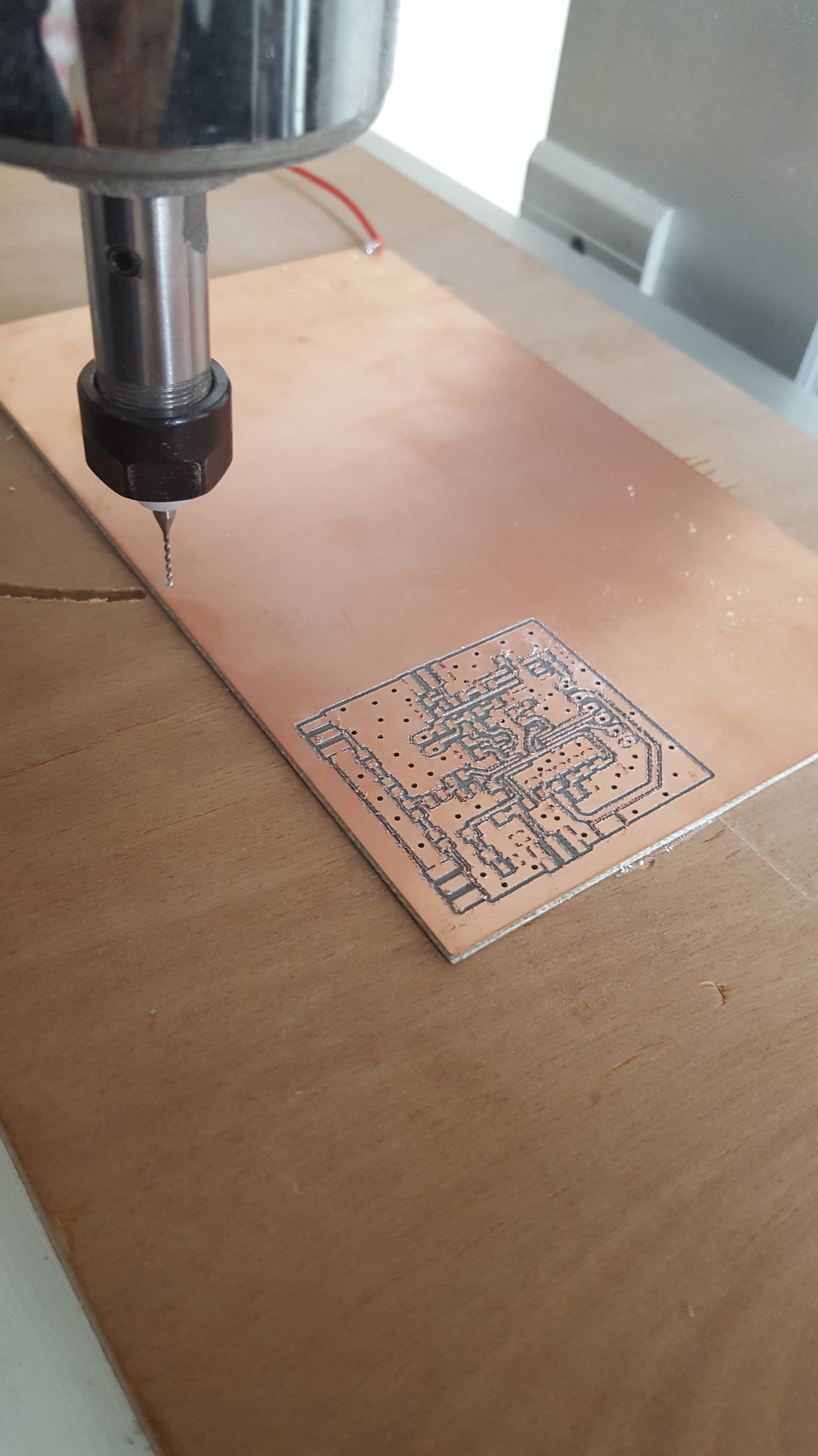

We begin by homing all 3 Axes, positioning the spindle roughly a few millimetres above a corner of the PCB and zeroing all 3 axes. It is important not to lose track of the X-Y zero position between the different jobs. Each new job will need a re-zeroing in the Z axis but the X and Y zero positions will be unchanged. Make sure the probing circuit is correctly set up, otherwise the mill will crash into the PCB! Once we engage the job the Mill should start the probing routine. Once complete, the milling routine will begin, depending on your feedrate and number of passes, this usually takes a while. Once this is complete our board should hopefully resemble our design albeit cluttered in fibreglass dust.
Next, we move on to the drilling, this step does not need precise re-leveling. We simply insert the drill bit, and zero the Z axis with the bit laying flush against the PCB surface. Once this is complete all the specified holes should be drilled into the board.
Last but not least, the board needs to be cut out from the rest of the PCB clad. This process is very similar to the previous step albeit with a different bit and slower feedrate. Once again we re-zero the Z axis and let the job run. If all went well we should have the finished PCB!

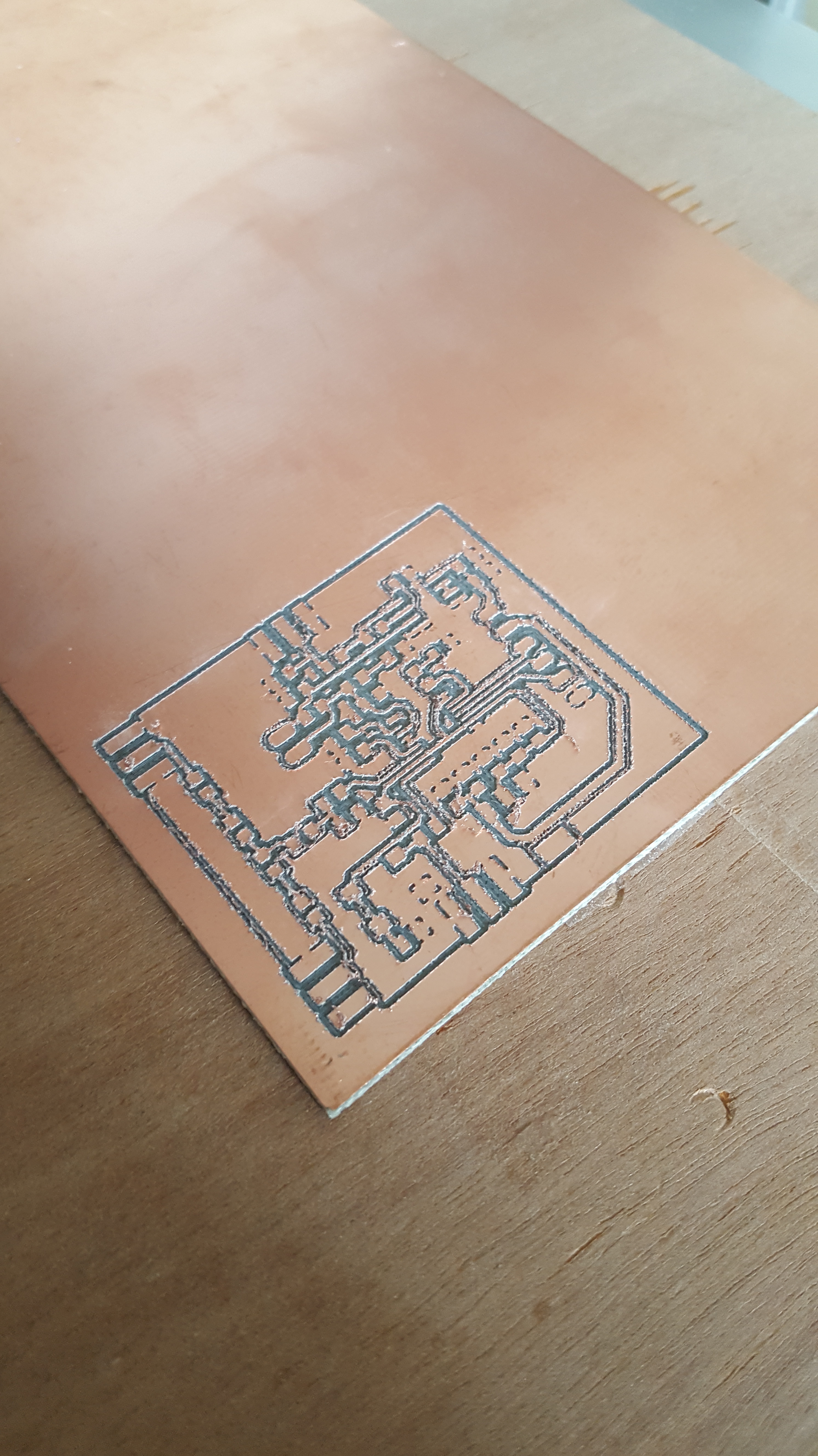

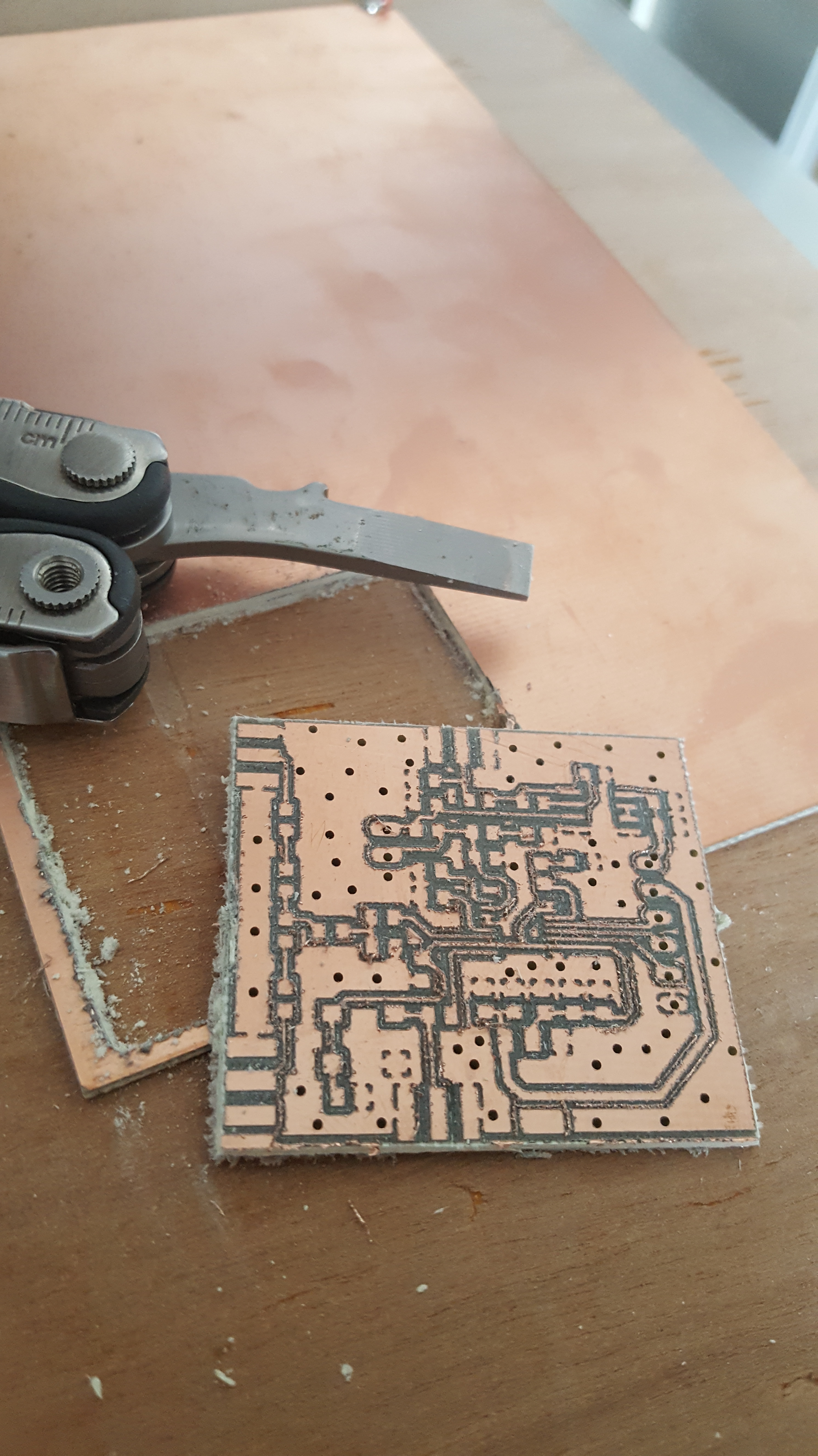

Now onto the more rewarding parts of the process. The milling process is not perfect, especially as the engraving bit gets blunt, it tends to tear rather than cut. To clear off stray copper filings, give the PCB a good scrub, first with the thick bristle brush and followed by the finer sanding paper. After a final wipe with some rubbing alcohol, we can finally solder the components on!
Take a look at the final result. It looks pretty good, although you can see some imperfections such as residual copper traces in between actual traces. These should not be a problem as we specified sufficient clearances between traces and pours!

Great writeup, thanks for that. I have some small issues:
\cite{ I use a cutting depth of 0.8 mm with a 0.1 mm V-bit. } – Is that a typo or do you really cut in almost a millimeter? This is way to much. Depending on the bit, 0.1-0.2mm (I use 45° carving bits) are more than enough to reliably cut through the copper (also depending on the rigidity of the Z-axis).
The cut-out board on your picture looke terrible – was the cutter blunt? I get clean cutting edges when cutting out FR4 board with a simple 2- or 4-flute cutter bit.
Spindle running at 24,000 RPM and I get very clean cuts.

You don’t have to sand your board if you have sharper tools and proper settings, don’t settle for the shitty high speed steel ones, go for the cemented carbide. They do not wear out unless you plan on cutting hundred’s of boards, they can also do higher feed rates without heating up and breaking. Heat is your worst enemy for keeping tools sharp while machining.
Now with the right tool in place, use really high rpm, 30000 or higher is optimal.
Then keep your feed-rate at 50-100 mm/min.
Keep your depth at around -0.2 to 0.3 mm, if you go to deep you get wide tracks, to shallow and you get burs.
Drench your board in oil. This has to uses: Firstly, it keeps you tool tip cool so it stays sharp and hence you avoid burs.
Secondly, it catches all the dust so you don’t need to use a vacuum cleaner or you lungs to suck it up, just wipe it of when it’s finished. As a added bonus it also keeps the noice down as it dampens the vibrations.
It took me a couple of hours of thinking and testing to come to this conclusion but it was worth it. There’s a cheap 200$ CNC to the right of my keyboard running a PCB as I type this. I don’t even have to watch it while it’s running, just playing games and reading meanwhile. Never again will I use acids for making PCB:s, that’s just painfully time consuming and boring.
