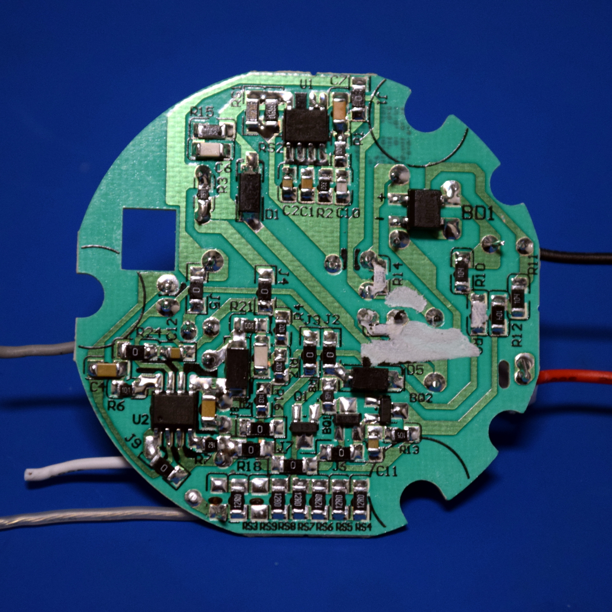

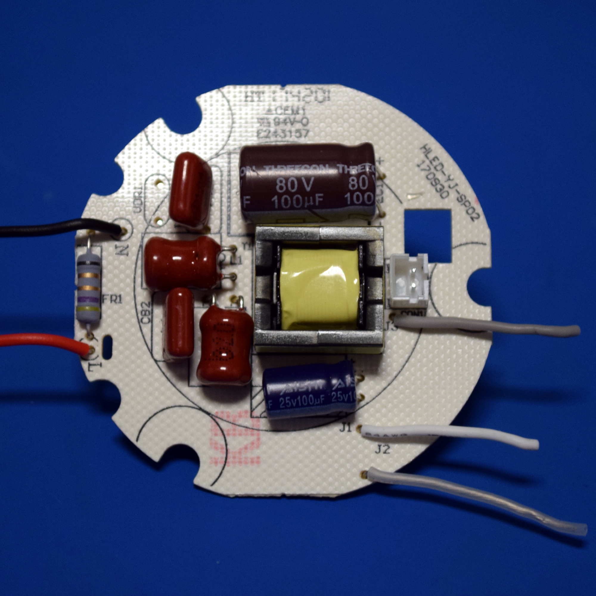

Power Supply
The board should look pretty familiar if you’ve ever seen the inside of an LED bulb before. It’s a double-sided PCB with a fairly simple layout: transformer and capacitors on the top side for AC to DC conversion, with the flip side featuring the brains of the operation. The white connector on the top side of the board connects to the 3.7V 2000mAh battery, which incidentally takes up most of the internal volume of the bulb.

Is there any isolation from the mains in this unit, or is the load hot?
That is something to check as it will be a deal breaker.
This was my first thought. There is no isolation on that power supply PCB. Extremely dangerous to use when handling the powered device or connecting it to anything else.
Looks like there is a direct connection between the “hot” side and the low-voltage side, through J4 (a zero-ohm resistor). Then there is the power-fail detect circuit, which probably puts a low voltage DC bias on the input through some moderate impedance, provided by the battery. Looks like this happens through R9-R12.
This circuit should be treated with the same respect and caution as any other directly mains-powered circuit.

Indeed, I’m fairly sure there is no isolation, since the detection of the power failure would be very difficult that way. Why would anyone design this with galvanic isolation? It’s completely unnecessary, complicated and expensive.
I don’t see any other inductors, so I doubt that transformer is really just that; I suspect it actual is an air-gapped inductor, either a single one, or a coupled inductor with an airgap for a step-down flyback converter.
I sort of expected the LEDs to be driven with a lower current, instead of having two sets of LEDs. With a flyback converter you could use the secondary winding as the storage coil for a boost converter.

And this system doesn’t have galvanic isolation from the AC line.
That’s okay sometimes – you can run a microcontroller from a transformerless power supply or other non-isolated environment, but make sure you understand the consequences of that and what not to do.

PCB fab house worker here, CEM board with copper on one side is still called a single layer (/side) PCB. Having through hole components on one side and SMD in the other doesn’t make it double sided.
And also, the LED board is made in Xiamen region, while the transformer board is made 600km away in Guangdong region in China. I’m used to seeing boards atleast made around the same region, even if the factory is not the same.
