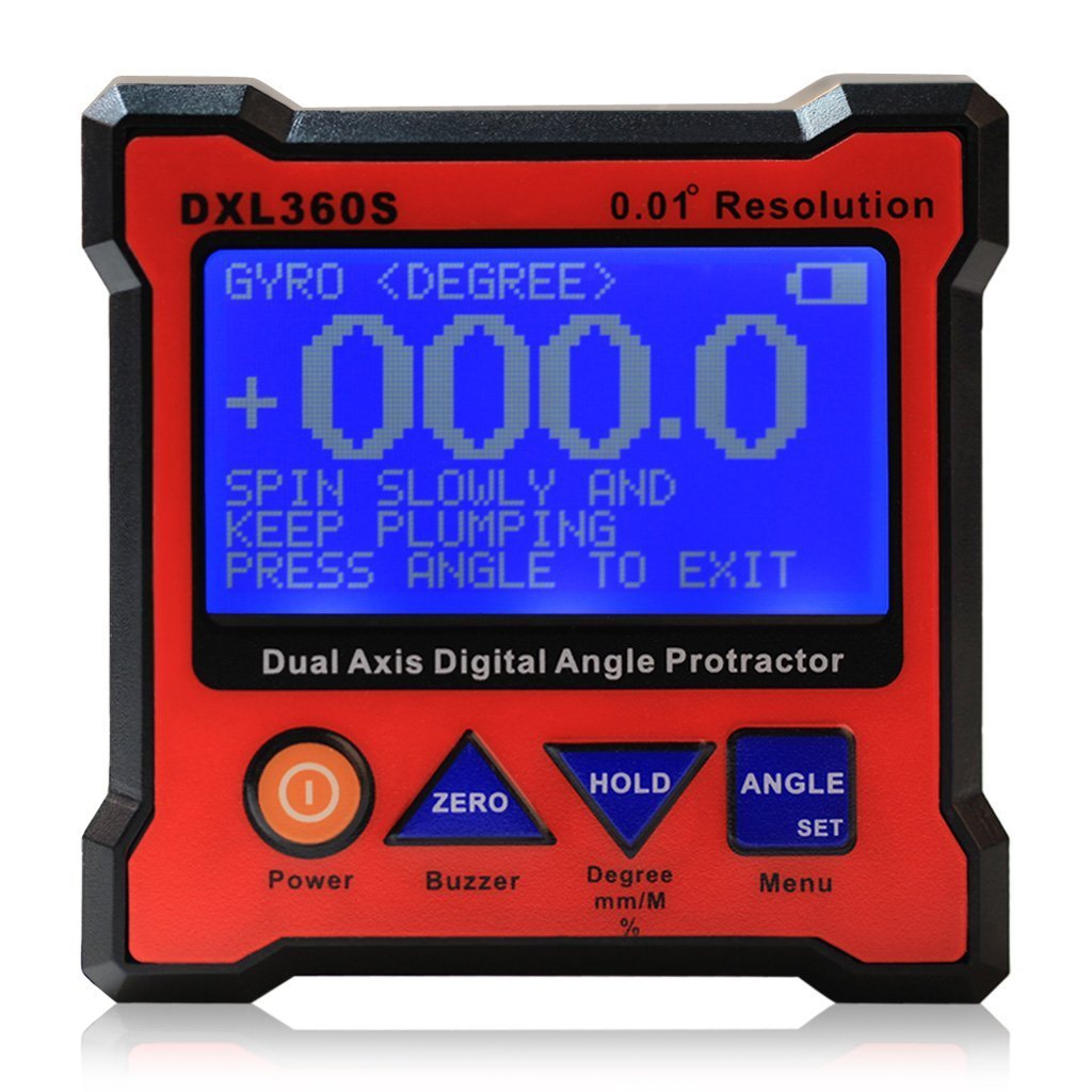

All the same arguments about leveling machine tools apply to 3D printers, too. I have always put leveling feet on my printers and adjust them whenever a machine gets moved. I started with a bubble level but found it wasn’t sensitive enough, so I later went to placing a large ball bearing (like 1.5″ diameter) on the t-slot and adjusted so it wouldn’t roll. But that isn’t so good for use on some of the other parts of the machine, so I got a digital protractor like this one:
https://images-na.ssl-images-amazon.com/images/I/61ATtV1UxuL._SL1024_.jpg
It’s a lot more sensitive than a bubble level and really helps dial in the leveling. It’s also good for ensuring that the XY plane is perpendicular to the Z axis, something a lot of printer builders neglect.
“Spin Slowly And
Keep Plumping”
Sounds like good general advice to me.
“Spin slowly and keep plumping”
Keep plumping?
But, I’m trying to lose weight!
B^)
I have a bubble level that is sensitive to .0005″ in 10″. I can guarantee this device is not that sensitive.
+1
The Starrett at .0005″/ft is about five times more sensitive (asin(.0005/12)=.0023 degrees). Please also keep in mind that resolution is not accuracy.
