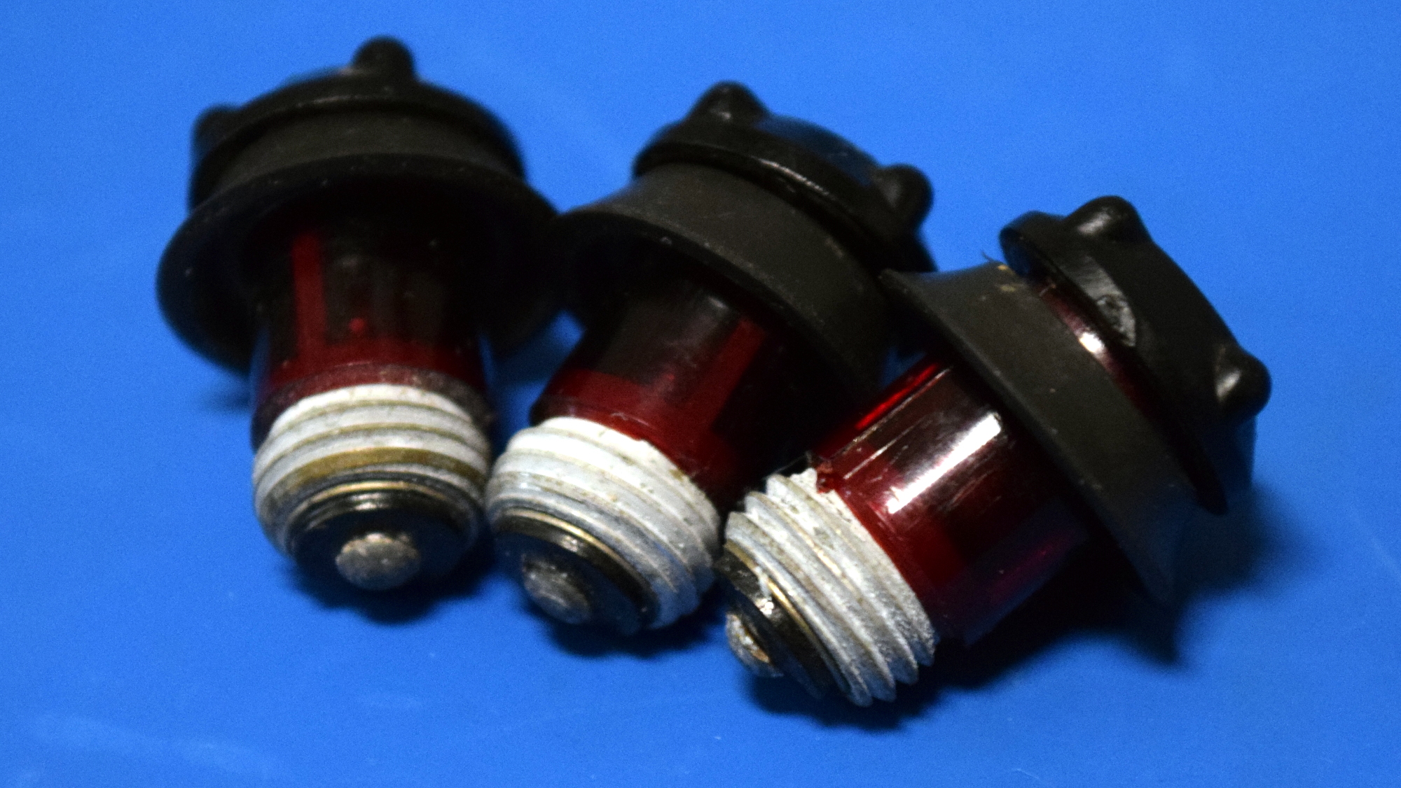

Lighting
We take things like tiny PWM controlled LEDs for granted. Back in the day, engineers had to get more creative when it came to something as simple as lighting a panel like the C-1282. The front panel of the device features an internal diffuser which takes the light from three red incandescent bulbs and evenly distributes it. This is best demonstrated by removing the main knob on the front of the device, as you can see the inside of the diffuser on both the back of the knob and the panel itself.
The “Signal” light, which would indicate each time chaff was released, is particularly interesting. This is a light that should be bright enough to get attention, but not so bright as to be distracting or even blinding in the dark confines of the bomber. Accordingly, the EWO had the ability to adjust how bright the light was by turning the knurled top of the indicator.
Turning the indicator opens and closes internal “shutters” that go from nearly complete occlusion of the internal GE-313 bulb to wide open. No electronic dimmers, no circuitry, just brilliant engineering.

    2. Those indicators and the intricate, carefully designed bulb diffusers are part of such a marvelous lost art of instrument lighting. They have this wabi aesthetic that I really miss and value in our age of chintzy LED RGB glow-trash. I really love old instrumentation and often seek it out on ebay and such to use for custom motorcycle builds and other art projects.
