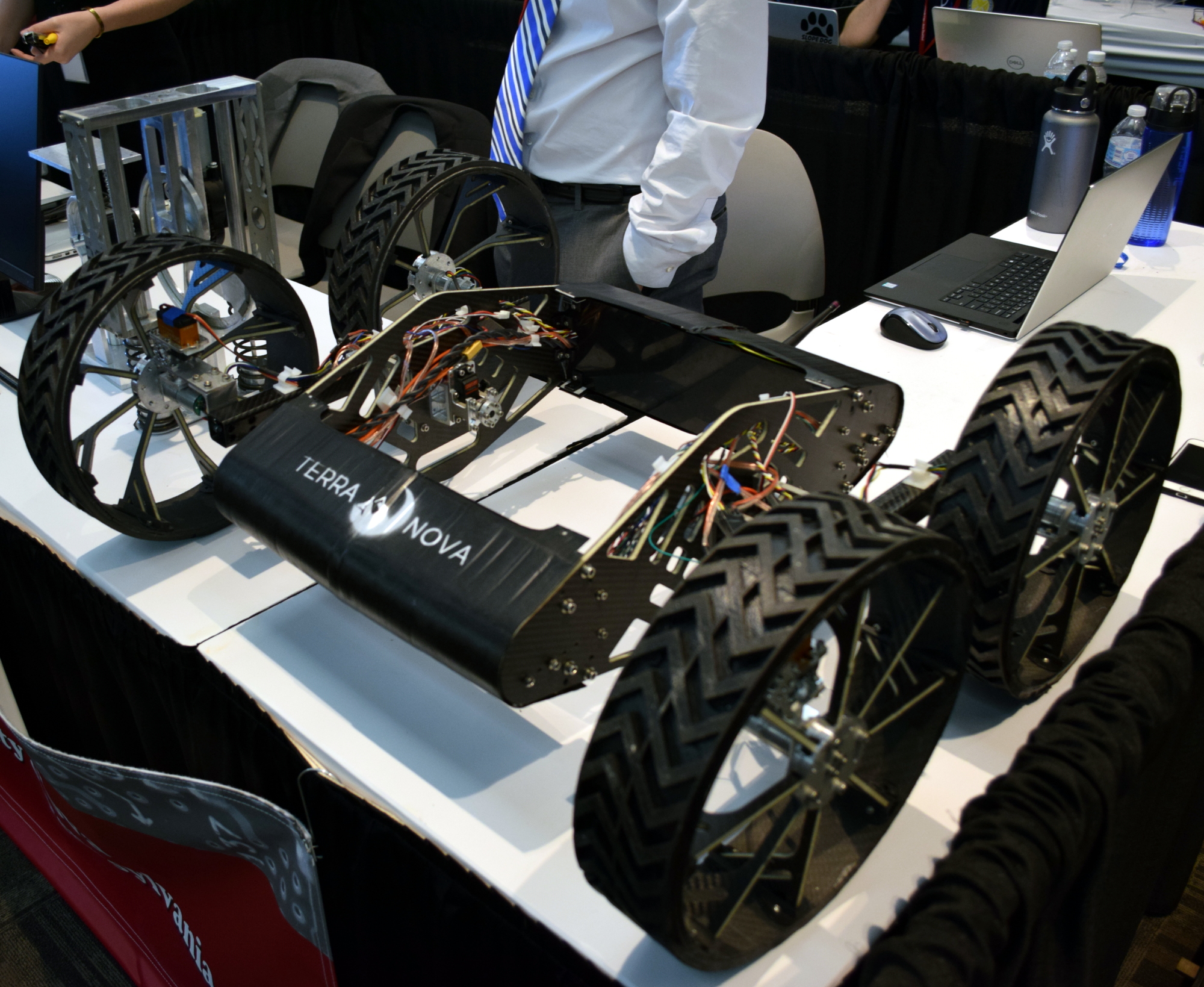

Not all of the problems tackled during the Cornell Cup were of Earthly origin. It’s theorized that caves on the Moon would make an ideal starting point for a future human outpost, but up until this point, they’ve gone completely unexplored. In lieu of relatively sure-footed human explorers, it would take an exceptionally nimble rover to descend more than a few feet into these caves.
Enter TerraNova. This rover design is not only able to handle rough and uneven terrain, but it has a secret weapon: a spring-loaded vertical leap capability designed to get it out of trouble. On the Moon, the team estimates their system should be able to propel TerraNova one meter into the air without expending any fuel. With the addition of gas thrusters, this ability could potentially be expanded to performing the sort of long-distance horizontal “hops” required by the unclaimed Google Lunar X Prize.

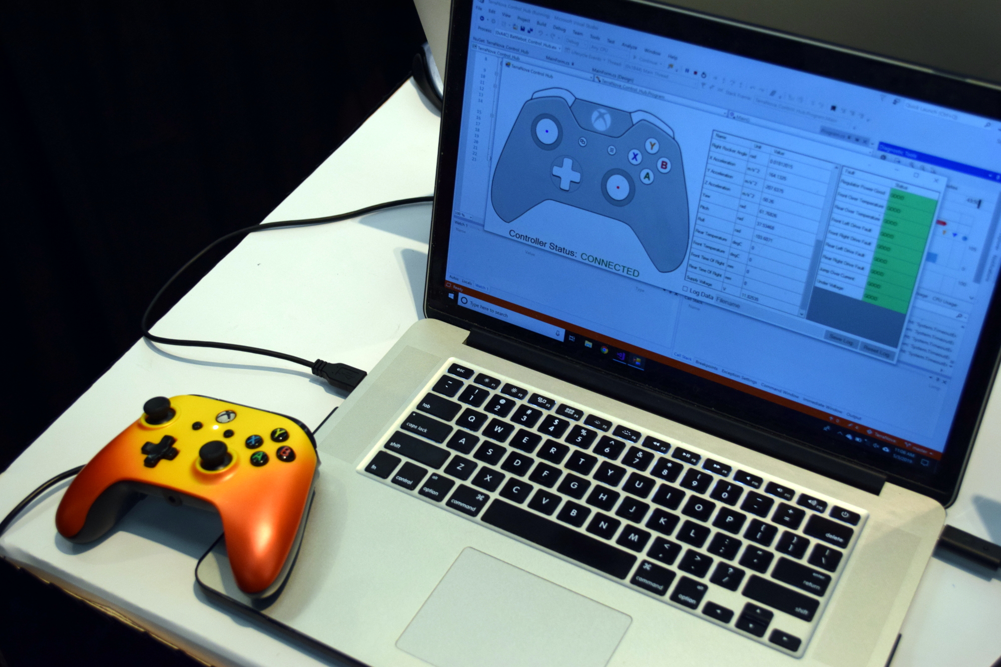

As impressive as the rover is, Team TerraNova has no illusions about their machine actually going to the Moon. But then, that was never really the goal. The hope is that the research and engineering done during the development of their leaping rover could prove useful to NASA or other entities performing future lunar missions. Of course, knowing you don’t have to design your vehicle to operate hundreds of thousands of miles from home has its advantages; namely the ability to use consumer-grade components and swapping out a complex semi-autonomous control system for an Xbox controller hooked up to a laptop.

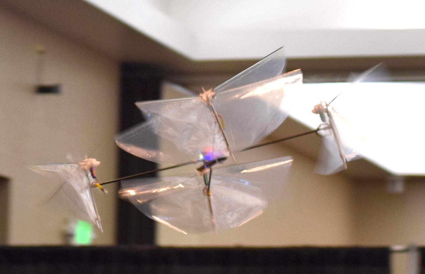

Last but certainly not least is the Flapping-Wing Micro Air Vehicle (FWMAV) from the University of California, Irvine. Essentially, the team took the traditional quadcopter design we’re all familiar with and replaced the spinning propellers with four sets of ornithopter wings. The amalgamation of these two vastly different styles of flight results in a vehicle with the maneuverability of a quadcopter but without the noise and hazardous blades which thus far have been considered part and parcel with small UAVs.
It’s one thing to understand the physics of how it flies, but it’s quite another to see it in the air. The FWMAV doesn’t just fly, it zooms. A side-effect of the ornithopter wings is that the craft is capable of very nearly horizontal flight, but with the hovering ability and pinpoint landing accuracy of a helicopter. We’re told that the team received special dispensation from NASA to fly the FWMAV around the conference center, a decision which was surely appreciated by all those in attendance.
Without the spinning blades, the FWMAV is much safer than traditional UAV designs. You can put your hand against the flapping wings and cause no damage to yourself or the aircraft. While it’s still far from silent, the movement of the wings makes for a far more organic noise than you might expect. Seeing it buzz and flit around the room, it seems more like a giant insect than a mechanical device.
Incredibly, every piece of hardware used in the FWMAV is an off-the-shelf component. From the flight controller to the ornithopter mechanisms, they’re all parts you can buy right now. The trick was combining them in a novel way. According to the team, the hardest part was modifying the flight controller’s open source firmware to handle the new propulsion system.
