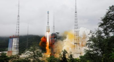

BeiDou
China’s final BeiDou satellite was launched on June 22, 2020. The booster made landfall downrange and set a small fire amongst some trees.
Spawned from discussions in the 1980s, China’s Beidou system kicked off with BeiDou-1, with the first launch taking place in 2000. A China-only regional system, it was superseded by BeiDou-2 which began launches in 2007 which began the march towards more global coverage. 2015 marked the start of BeiDou-3 deployment, with the final satellite of the constellation being launched on June 22, 2020.
With accuracy on the order of 10 meters for civilian use, it also delivers a military-only signal to the armies of China and Pakistan, reportedly down to 10 cm.  Short messaging capability is also included in the platform, though whether this will be available to the general public is not clear at this time. Around 70% of Chinese smartphones already support the system. With China’s huge manufacturing muscle and massive population, expect BeiDou hardware to become commonplace incredibly quickly.
