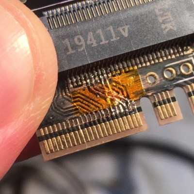

Any PCIe interface has two kinds of diffpairs – TX and RX; for an x1 link, you will have one TX diffpair and one RX diffpair, and a x16 link needs sixteen of each. As you might expect, RX on one end connects to TX on another end, and vice-versa – it’s just like UART, but spicy. Of course, if you’re doing a PCIe extender or socket-to-socket adapter of some kind, you don’t need to do any swapping. If you’re designing a board for one of the PCIe-carrying extension standards, the usual naming is host-side. For example, say you’re putting a PCIe Ethernet controller IC onto a PCB that plugs into a desktop PCIe socket – connect TX and RX of the PCIe socket board to to your Ethernet chip’s RX and TX respectively.
Swapping TX and RX will not work – I’ve learned the hard way
If there’s strong indication that this convention has been violated, don’t fret – make sure to compare to an existing host or device, and see if you are able to determine whether the naming is as-expected or indeed, unexpectedly, flipped. Again, it’s just like UART! That said, there’s also AC coupling capacitors placed in series on both the TX and RX lines. Specifically in case of PCIe extension cards, be it M.2 or desktop PCIe, the convention is placing them on device-TX (host-RX) lines on the device board, and on the host-TX side (device-RX) on the host board. This alone is a pleasant divergence from UART when it comes to design and reverse-engineering.
