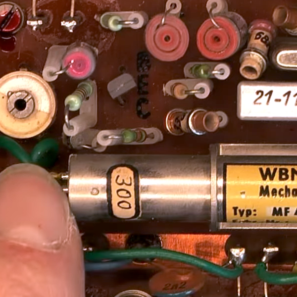

Inside is a neatly built RF circuit with obviously shielded compartments. In addition to a configurable power supply, the radio has modules that allow configuration to different frequencies. One of the odder components is a large metal cylinder marked MF450-1900. This appears to be a mechanical filter. There are also a number of unusual parts like dogbone capacitors and tons of trimmer capacitors.

the ‘mechanical filter’ is (to me) somewhat evocative of a surface acoustic wave filter. though in this case more like an analog computer made with springs and weights, whereas saw is more like a digital filter where the coefficients and mac is made with spacing and size of the interdigital fingers.

Can you match a mechanical filter to a mixer / IF amp the same way you would a crystal ladder? For instance could I use an L-network? I have a salvaged one in the junk box but never tried designing for it.
It’s a 1.9khz filter costs 25€ https://www.ebay.de/itm/196718836292?customid=&toolid=10050
Much more likely a 450 KHz filter.

What’s unusual with am EMF? They are the flagship of Russian ham diy and the East German ones are exceptional. They made my EKD500 receiver worth looking all the way in Lithuania to find one. Good buy.
