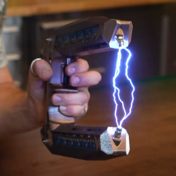

Bears! Are they scared of massive arcs that rip through the air, making a lot of noise in the process? [Jay] from the Plasma Channel sure hopes so, because that’s how his bear deterrent works!
[Jay] calls it the Bear Blaster 5000. Right from the drop, this thing looks like some crazy weapon out of Halo. That’s because it throws huge arcs at 280,000 volts. The basic concept behind it is simple enough—a battery drives a circuit which generates (kinda) low voltage AC. This is fed to the two voltage multipliers which are set up with opposite polarity to create the greatest possible potential difference between the two electrodes they feed. The meaty combination is able to arc across electrodes spaced over four inches apart. It’s all wrapped up in a super-cool 3D printed housing that really shows off the voltage multiplier banks.
Given its resemblance to a stun gun, you might think the idea is to jab an attacking bear with it. But the reality is, if the bear is close enough that you could press this device against it, you’re already lunch. [Jay] explains that it’s more about scaring the animal off with the noise and light it produces. We’d certainly take a few steps back if we heard this thing fire off in the woods.
[Jay] does a great job of explaining how the whole setup works, as well as showing off its raw ability to spark. We’ve seen some great builds from [Jay] before, too, like this beefy custom flyback transformer.

Regarding the resin, its just normal arts and craft clear resin right? Would I still get decent insulation if I don’t have a vacuum chamber? Embedded bubbles a problem?
Don’t really have much experience playing with high voltage. Highest I work with is 3.3V
Don’t make this unless your very familiar with high voltage and circuitry. I don’t have time to watch the video at the moment but stun guns are only relatively safe because the pulse is very brief and the skin effect prevents it from stopping your heart (skin effect is that electricity start transmitting from the outside surface first and then works towards the core). Assuming he is accounting and designing for that then any mistake with capacitance,resistance, or inductance would possibly extend the pulse and make it much more capable of killing you.

The sound this one makes is somewhere between 50 – 100 Hz which is perfect for causing muscles to lock up. Trouble is, you need to hit a muscle. Otherwise it’s just going to burn you.
A taser goes “pop pop pop” because it’s intended to jolt you around. With a higher frequency, you might be able to muscle against the shock and still maintain some coordination, but with the shocks coming in at a relatively low frequency, you’re just going all over the place.
MG Chemicals 832C embedding and potting epoxy.
https://mgchemicals.com/products/potting-compounds/epoxy-potting/clear-epoxy/
Embedded bubbles will be a problem, the breakdown voltage of epoxy is much higher than the breakdown voltage of air, and electricity will find the shortest path. Put it under vacuum while curing.

“Various sources online indicate that epoxy without any coloring additives are best, since most additives can be conductive. I found Total Boat Epoxy to be one such recommendation:
https://www.amazon.com/TotalBoat-Thickset-Casting-Crystal-Gallon/dp/B07QKF5F6F”
You can also use oil instead of epoxy, and this can help with heat dissipation. Search for dielectric oil, and this also should be put under vacuum, once at the time of construction, to remove dissolved air and prevent bubbles.
