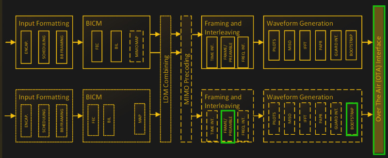

The Real Story
If you read the slide deck, the real story is at the end in the backup slides. That shows the ATSC standard frame and how the preamble changes. The math is fairly standard stuff. You know where the stations are, you know what time they think they sent the signal, and you can estimate the range to each station. With three or four stations, you can get a good idea of where you must be based on the relative receive times.
The stations diversify their time sources, which helps guard against spoofing. For example, they may get time information from GPS, the network, a local atomic clock, and even neighboring stations, and use that to create an accurate local time that they send out with their signal.
