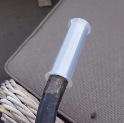

The CC3D 72D TPU filament used to print a bicycle's handlebar. (Credit: My Tech Fun, YouTube)
The CC3D 72D TPU filament used to print a bicycle’s handlebar grips. (Credit: My Tech Fun, YouTube)

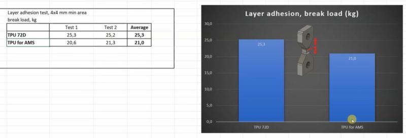

TPU is of course highly hydrophilic, so keeping the filament away from moisture is essential. Printing temperature is listed on the spool as 225 – 245°C, and the filament is very bendable but not stretchable. For the testing a Bambu Lab X-1 Carbon was used, with the filament directly loaded from the filament dryer. After an overnight print session resulted in spaghetti due to warping, it was found that generic TPU settings  at 240ºC with some more nylon-specific tweaks seemed to give the best results, with other FDM printers also working well that way.
The comparison was against Bambu Lab’s 68D TPU for AMS. Most noticeable is that the 72D TPU easily suffers permanent deformation, while being much more wear resistant than e.g. PLA. That said, it does indeed seem to perform more like polyamide filaments, making it perhaps an interesting alternative there. Although there’s some confusion about whether this TPU filament has polyamide added to it, it seems to be pure TPU, just like the Bambu Lab 68D filament.

  3. i’m interested in filaments with more flex and ‘toughness’, but i don’t have a project in mind off the top of my head. and the local bike shop sells perfectly fine mountain bike handlebar grips for about $10. not sure how tpu stacks up to the rubber but i’m gonna guess i prefer the rubber.
    so i guess – thanks! – i am taking this article as yet another example of why i don’t really need tpu :)
    1. TPU works extremely well for parts that will see abuse. Ideally, for grips you’d use a foaming TPU which can produce very soft and grippy parts at higher temps (costlier), or a low hardness TPU (difficult to print). But even a normal 90A TPU makes great grips when printed with a textured surface and low infill.
  4. I’ve made several test prints with the CC3D 72D TPU filament and my feelings are a bit mixed.
    If you print it right the layer adhesion is very good.
    But it’s very easy to mess the settings up. It seems if the previous layer is to cold then it will stick very poorly, much worse then PLA.
    I find it very difficult to find the right settings for temperature, fan speed and other slicer settings (speed), that influence the temperature / cooling.
    In my test i had the problem that 100% infill regions printed too hot and sparse infill regions too cold.
    This lead to either one region didn’t stick or the other region showing rough / wavy walls. Didn’t manage to get both right at the same time.
    I have to add that i didn’t print from a dryer, so moisture may also had an effect.
    The temperatures of the filaments touching is obviously not only determined by the temperature it leaves the nozzle but also how many time was there for the other side (previous layer) to cool down, geometry of the print, etc.
    Current slicers are very bad at predicting that, or they don’t do that at all.
