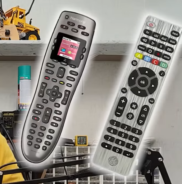

The host stands in his electronics lab with the image of four remote controls overlaid.
Over on his YouTube channel [Electronic Wizard] has released a video that explains how infrared (IR) remote controllers work: IR Remote Controllers protocol: 101 to advanced.
