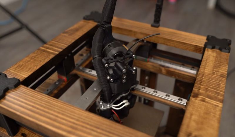

Generally, the frame and other structural parts of an FDM printer use steel or similar, but could you use wood instead for that truly artisan look? As [Mitsu Makes] demonstrates after half a year of work, you absolutely can, and it looks about as amazing as you might imagine.
Naturally, you cannot make everything out of wood – such as the linear rails and lead screws – and there is a fair bit of FDM-printed black PLA in there too, but the wood is both structural and decorative. The stained look does really add something. For the FDM-specific parts, the Voron 0 was taken as the base, including the bed. The motion system isn’t CoreXY but Cartesian for ease of construction and driving the axes, while also providing more torque due to the additional motors.
Since it’s more or less a Voron FDM printer and even has automatic bed leveling, it works basically perfectly after assembly and input shaping. Even if it’s not the most practical way to make your own FDM printer from parts, it definitely makes it look unique and would be the focal point of any printing farm.

    1. When the whole printer is changing by perhaps a few degrees, maybe tens of degrees in your not climate controlled garage the thermal changes in the room are not very relevant, and usually won’t matter anyway as the entire printer changes comparably meaning lots of the changes will cancel out.
      Even with the heated chamber printers where everything might get near 100 degrees different from a cold to a hot print its pretty much irrelevant to the frame – look up shrink fit guides to see just how extreme the temperature delta needs to be for your two almost matching sized parts as a ballpark to consider. The microns of change the frame is likely to see assuming it isn’t made in crazy zero expansion composite structures will be lost entirely in the noise of FDM 3d printing’s layer lines and squeeze out anyway.
      I agree this largely wooden printer is likely to have trouble if it isn’t kept climate controlled, but probably not enough to really matter either – FDM printer can be really quite floppy and imprecise and still do reasonably good prints.
      1. The bit to remember with your musical instrument to a printer comparison is the instrument is really very functionally its frame, change that change the sound, where the 3d printer the functionality comes from its motion works, and while those might end up shifted from where they were the 1 step of the stepper or 3 degrees rotation on the closed loop motor will still equate to very much the same motion relative to itself – the belt and wheels might have a bit more/less tension in them but as long as it won’t slip they still work and the distance moved per step really isn’t very impacted – the shrink rate of the plastic you are printing will dwarf the variation in the printer.
      2. FDM printer can be really quite floppy and imprecise and still do reasonably good prints.
        Being floppy is what makes it work – it allows the geometry to adjust so the bearings and rails don’t bind up. If the frame is rigid, and the geometry warps because of expansion, everything stops moving.
    2. The temperature (and therefore the size) of the 3D printer frame shouldn’t change much while you’re actually doing the printing.
      With enclosed 3D printers, you usually want to heat up the chamber before you start printing, so that the air is already warm when you start the print, and stays the same temperature the whole time (so that the plastic doesn’t cool down and warp the print until it’s done and everything’s fully supported). This has a side effect of heating up the frame and causing it to expand before the printing starts. You do all your tuning and calibration with an already hot printer frame, so you compensate for any expansion without ever really thinking about it.
      For open, non-enclosed printers, the frame doesn’t get much hotter than room temperature, so it doesn’t change much. But you still heat up the bed before you start doing any auto-leveling, so that it takes the temperature-based movement into consideration.
      There were some Voron people who made a script for Klipper a few years ago to try to compensate for thermal expansion like you’re saying, to try to start printing early before the printer fully heated up, but I don’t remember it really doing much because the affect was so small.
    3. And come to think of it, even though metal doesn’t expand and shrink with moisture, it still does with temperature. How is that affecting prints in real life?
      Wood takes a long time to absorb moisture from air, so it tracks the ambient humidity very slowly, but over a year it can change 1-5% in size across the grain. That’s why cabinetmakers leave space for expansion around large panels.
      Metals like steel have a typical thermal expansion of 10-15 parts per million, so you need to heat the linear rails until they’re white hot before it expands as much as the wood does.
