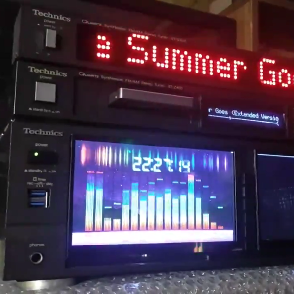

Vintage hi-fi gear has a look and feel all its own. [ThunderOwl] happened to be playing in this space, turning a heavily-modified Technics stereo stack into an awesome neo-retro PC case. Meet the “TechnicsPC!”
This is good. We like this.
You have to hunt across BlueSky for the goodies, but it’s well worth it. The main build concerned throwing a PC into an old Technics receiver, along with a pair of LCD displays and a bunch of buttons for control. If the big screens weren’t enough of a tell that you’re looking at an anachronism, the USB ports just below the power switch will tip you off. A later addition saw a former Technics tuner module stripped out and refitted with card readers and a DVD/CD drive. Perhaps the most era-appropriate addition, though, is the scrolling LED display on top. Stuffed inside another tuner module, it’s a super 90s touch that somehow just works.

“Live test”. All more or less as planned, as “cons” – it does not interrupt ongoing scroll cycle with new stuff, it puts new content info with next cycle, so, kinda “info delays”:

    2. Thank You for nice words! When HTPC cases were an actual thing, I never made PC in to one, for two reasons – one being monetary, and second, they did not quite “fit” by design in to existing Hi-Fi racks. But, this above, it is not my first Hi-Fi-PC, it is third actually. Or fourth, if we count original first XboX monted in to Sony SD player case… :-) Or fifth, if we count “AIWAndroid” project. If you look up these things on my Twitter or Bluesky, you’ll see. Yes, I need to organize a web page about all that and more. Most likely I will expand my https://ThunderOwl.One web links place, some day. Stay tuned. :)
