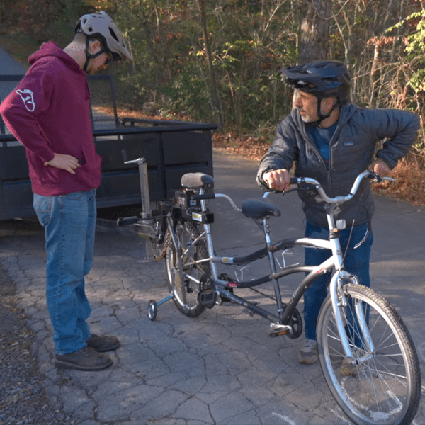

Bicycle Tows 15,000 Pounds
An old joke in physics is that of the “spherical cow”, poking fun at some of the assumptions physicists make when tackling a new problem. Making the problem simple like this can help make its fundamentals easier to understand, but when applying these assumptions to real-world problems these assumptions are quickly challenged. Which is what happened when [Seth] from Berm Peak attempted to tow a huge trailer with a bicycle — while in theory the bike just needs a big enough gear ratio he quickly found other problems with this setup that had to be solved.
[Seth] decided on a tandem bike for this build. Not only does the second rider add power, but the longer wheelbase makes it less likely that the tongue weight of the trailer will lift the front wheel off the ground. It was modified with a Class 3 trailer hitch, as well as a battery to activate the electric trailer brakes in case of an emergency. But after hooking the trailer up the first time the problems started cropping up. At such a high gear ratio the bike is very slow and hard to keep on a straight line. Some large, custom training wheels were added between the riders to keep it stable, but even then the huge weight still caused problems with the chain and even damaged the bike’s freehub at one point.
Eventually, though, [Berm Peak] was able to flat tow a Ford F-150 Lightning pulling a trailer a few yards up a hill, at least demonstrating this proof of concept. It might be the absolute most a bicycle can tow without help from an electric motor, although real-world applications for something like this are likely a bit limited. He’s been doing some other bicycle-based projects with more utility lately, including a few where he brings abandoned rental e-bikes back to life by removing proprietary components.

  5. while in theory the bike just needs a big enough gear ratio he quickly found other problems with this setup that had to be solved.
    First principle analysis: 7 tons up a hill takes about 70 kJ per meter of elevation. A single person can sustain 250 Watts. The maximum climb rate is therefore 1 meters per 280 seconds. If you’re pedaling up a 5% grade, you’re going 20 meters sideways for ever 1 meters up, so your maximum towing speed is 20 m / 280 s = 0.07 m/s or about 260 meters per hour per person.
    The same 5% grade gives a leverage factor of 20, so lifting 7 tons turns into 350 kg pulling at the wheels. Bicycle tires have a coefficient of friction up to 1.0 so you need at least 350 kg on the bike to keep it from slipping. Two adult men plus the bike itself is probably only around 200 kg.
