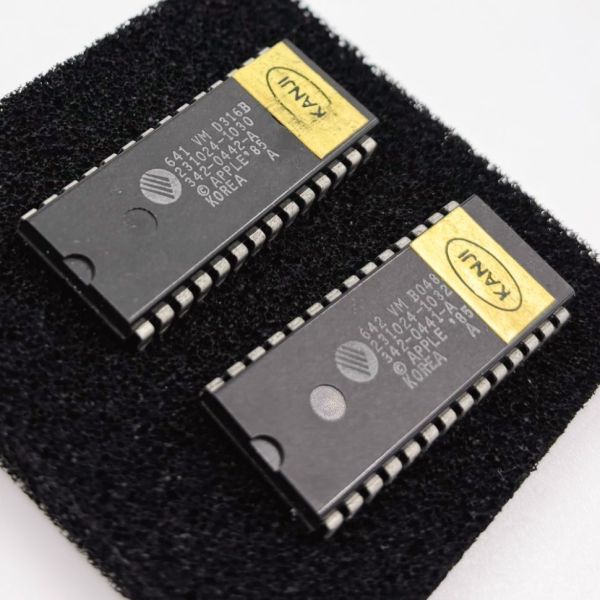

The Apple Macintosh Plus was one of the most long-lived Apple computers and saw three revisions of its 128 kB-sized ROMs during its life time, at least officially. There’s a fourth ROM, sized 256 kB, that merges the Western ROMs with Japanese fonts. This would save a user of a Western MacIntosh Plus precious start-up time & RAM when starting software using these fonts. Unfortunately, this particular ROM existed mostly as a kind of myth, until [Pierre Dandumont] uncovered one (machine-translated, French original).
The two 128 kB EPROMs containing the special MacIntosh Plus ROM image. (Credit: Pierre Dandumont)
Since this particular ROM was rumored to exist somewhere in the Japanese market, [Pierre] went hunting for Japanese Macintosh Plus mainboards, hoping to find a board with this ROM. After finally getting lucky, the next task was to dump the two 128 kB EPROMs. An interesting sidenote here is that the MacIntosh Plus’ two ROM sockets use the typical programming voltage pin (Vpp) as an extra address line, enabling 256 kB of capacity across the two sockets.
This detail probably is why this special ROM wasn’t verified before, as people tried to dump them without using that extra address line, i.e. as a typical 27C512 64 kB EPROM instead of this proprietary pinout, which would have resulted in the same 64 kB dump as from a standard ROM. Thanks to [Doc TB]’s help and his UCA device it was possible to dump the whole image, with the images available for download.
Using this ROM image was the next interesting part, as [Pierre] initially didn’t have a system to test it with, and emulators assume the 128 kB ROM format. Fortunately these are all problems that can be solved, allowing the ROM images to be validated on real hardware as well as a modified MAME build. We were informed by [Pierre] that MAME releases will soon be getting support for this ROM as well.

    1. The first 128 KB of the 256 KB dump is exactly identical to the already-well-known Mac Plus v2 ROM. Looking at the source code to CopyRoms, it uses the ROM checksum (stored in the first 4 bytes of ROM) to identify the ROM and decide how much to dump. So if anybody had used CopyRoms to do an in-system dump, it wouldn’t have detected the extra 128 KB of data after the normal ROM, and they would have thought they just had a normal 128 KB v2 ROM instead of a special 256 KB Kanji ROM.
      I think the first half being identical is why this Kanji ROM went undumped for so long. On the hardware ROM dumping side, there’s another issue: I think there is somewhat of a hole in ROM programmer support for mask ROMs that use all the address pins. For example, when I search through the XGecu software, I don’t find any 1024-kilobit devices in DIP28 form factor. There are lots of devices with 512 in their name, but nothing with 1024. So if I had these chips, I couldn’t have completely dumped them with my T56, at least I don’t think so. It’s like there needs to be an extra “dump only” mode for certain ROM pinouts that don’t have any kind of VPP/!WE pin but have an extra address line in their place instead. Maybe other ROM programmer devices already have this issue solved — I’m not sure.
