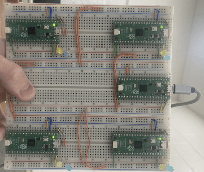

The five picos on two breadboards and the results of image convolution.
Here’s something fun. Our hacker [Willow Cunningham] has sent us a copy of their homework. This is their final project for the “ECE 574: Cluster Computing” course at the University of Maine, Orono.
It was enjoyable going through the process of having a good look at everything in this project. The project is a “cluster” of 5x Raspberry Pi Pico microcontrollers — with one head node as the leader and four compute nodes that work on tasks. The software for both types of node is written in C. The head node is connected to a workstation via USB 1.1 allowing the system to be controlled with a Python script.
The cluster is configured to process an embarrassingly parallel image convolution. The input image is copied into the head node via USB which then divvies it up and distributes it to n compute nodes via I2C, one node at a time. Results are given for n = {1,2,4} compute nodes.
It turns out that the work of distributing the data dwarfs the compute by three orders of magnitude. The result is that the whole system gets slower the more nodes we add. But we’re not going to hold that against anyone. This was a fascinating investigation and we were impressed by [Willow]’s technical chops. This was a complicated project with diverse hardware and software challenges and they’ve done a great job making it all work and in the best scientific tradition.

    1. I was thinking the same. I hate I2C with a passion. Slow and unreliable. SPI would have been better. I think you can even implement QSPI with the PIO blocks.
    2. There’s enough (in this case unused) I/O to make an extremely high bandwidth custom communications channel between these chips, but I somewhat understand the desire to go with something standard, to reduce complexity of the overall project.
    3. Yes I was thinking the same thing. It would be interesting to run the experiment again using SPI. Just for fun, naturally. I would be that the system would still be IO bound even if we used SPI or QSPI.
