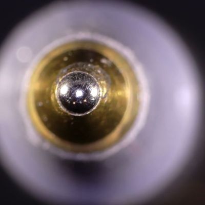

The depth of field you get with a cheap Tomlov DM9 digital microscope. Pictured is the tip of a ballpoint. (Credit: Outdoors55, YouTube)
We have all seen those cheap digital microscopes, whether in USB format or with its own screen, all of them promising super-clear images of everything from butterfly wings to electronics at amazing magnification levels. In response to this, we have to paraphrase The Simpsons: in this Universe, we obey the laws of physics. This applies doubly so for image sensors and optics, which is where fundamental physics can only be dodged so far by heavy post-processing. In a recent video, the [Outdoors55] YouTube channel goes over these exact details, comparing a Tomlov DM9 digital microscope from Amazon to a quality macro lens on an APS-C format Sony Alpha a6400.
First of all, the magnification levels listed are effectively meaningless, as you are comparing a very tiny image sensor to something like an APS-C sensor, which itself is smaller than a full-frame sensor (i.e., 35 mm). As demonstrated in the video, the much larger sensor already gives you the ability to see many more details even before cranking the optical zoom levels up to something like 5 times, never mind the 1,500x claimed for the DM9.
On the optics side, the lack of significant depth of field is problematic. Although the workarounds suggested in the video work, such as focus stacking and diffusing the light projected onto the subject, it is essential to be aware of the limitations of these microscopes. That said, since we’re comparing a $150 digital microscope with a $1,500  Sony digital camera with macro lens, there’s some leeway here to say that the former will be ‘good enough’ for many tasks, but so might a simple jeweler’s loupe for even less.

  2. This guy is comparing sloppily made pictures with a $150 camera +lcd setup with carefully stacked images from his 10x more expensive camara to which he added probably more than double that amount of hardware for the computer.
    Then @4:00 he needs a few minutes to explain that if you scale the image on a monitor to have the same size as the real life object, then it has the same size as the real life object.
    Then @05:00 he’s showing the ballpoint view of his carefully focus stacked expensive camera while it’s looking at a pocket knife. I assume this is meant to be some kind of humor but I have had enough and did not see the rest of the video.

  6. What he doesn’t let on is that with the expensive Sony with the huge sensor, you must stack multiple photos to get any depth of field. And this requires a lot of exposure time and substantial post-processing on a computer, so not remotely real-time.
    A smaller camera with smaller sensor intrinsically has a much larger depth of field, and lets you do real-time imaging. Equip both with a similar quality lens and lighting, and you’ll find the smaller camera much better suited to the moderate-magnification real-time inspection task.
    He’s just looking ridiculous, trying to compare two very different things on a task neither are ideal for. Like asking “What’s better, an e-bike or a ford 150?”
